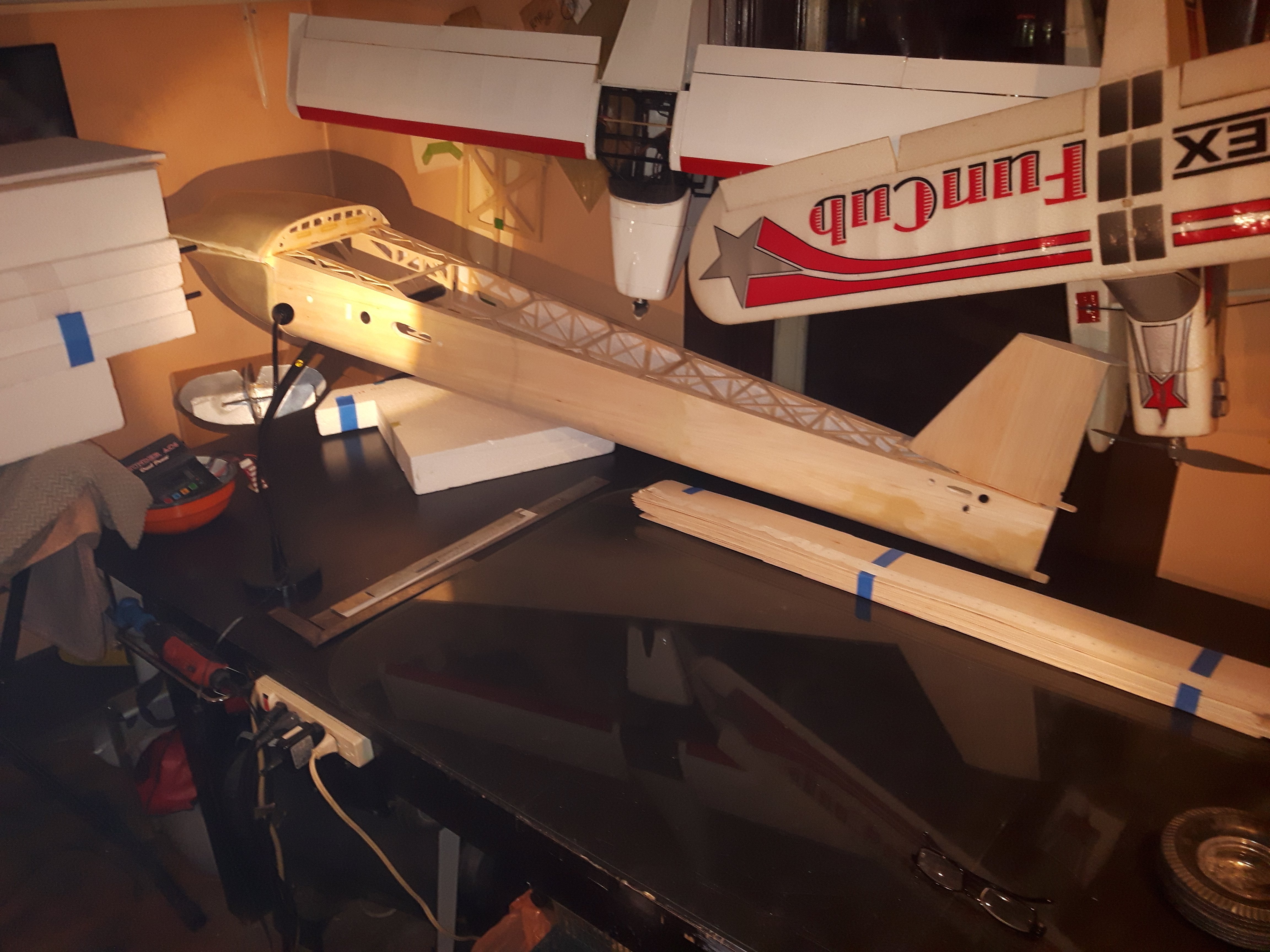

    I finally have a build worth posting here. I received a part built 2 meter Vertigo last weekend. Still a long way to go with it.

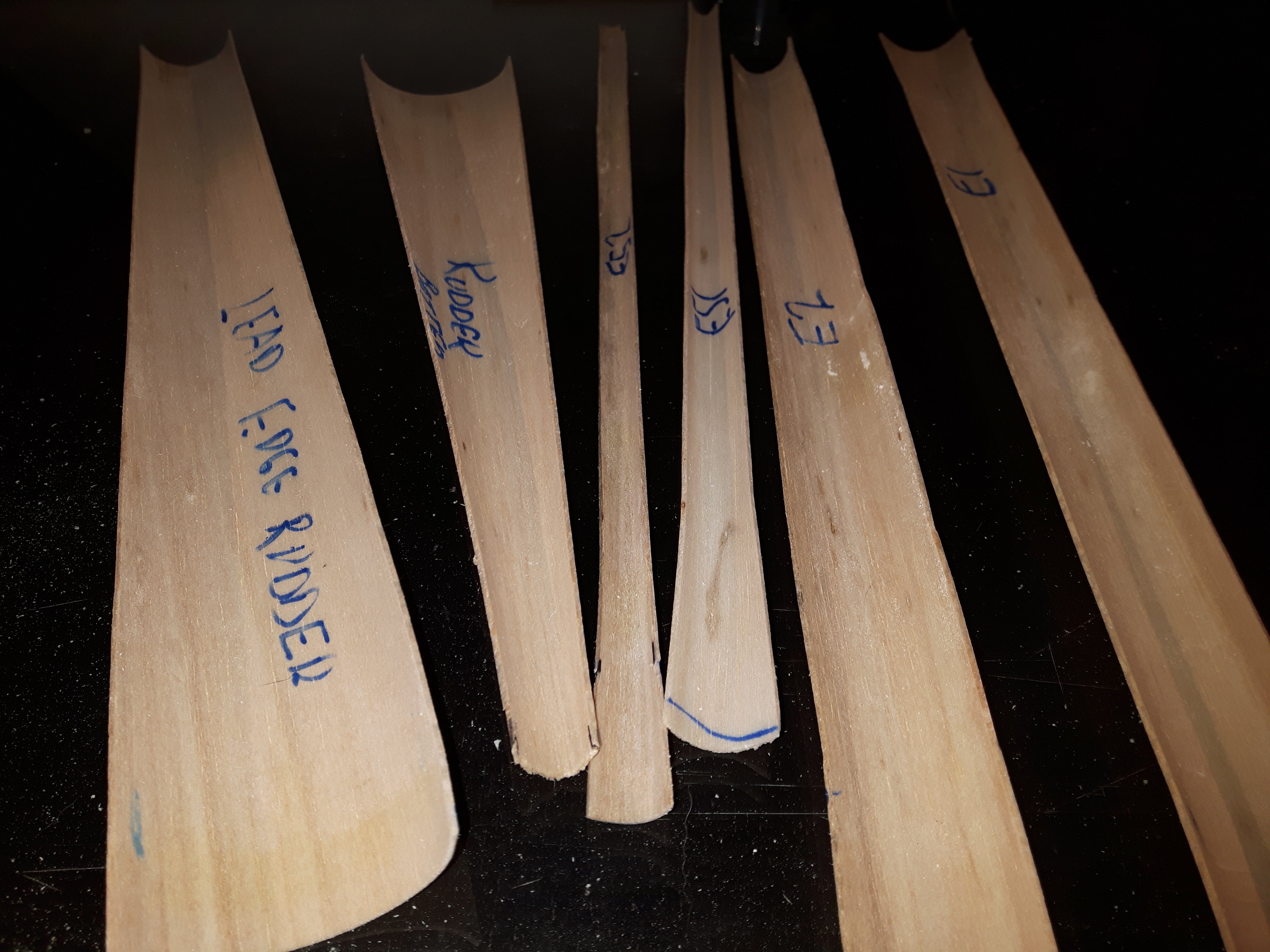

    Yes the Vertigo from Badan kits is a totally different type of build that I am used to. As I said I bought this kit that had been partially built. When I pulled up beside the gent that sold it to me in a parking lot it seemed like he had a van load of foam! That is what this kit is. Instead of sheeted wings almost everything on this plane is sheeted foam. I have to say this design is brilliant!
    Because there is so much sheeting to do I had to pick up some special glues to work on it. I heard that gorilla glue works but can leave the sheeting a little wavy so I picked up some West system epoxy which works well and keeps the weight down. I lot of what I am doing I am copying from one of the best builders in Canada, Trevor Brum.

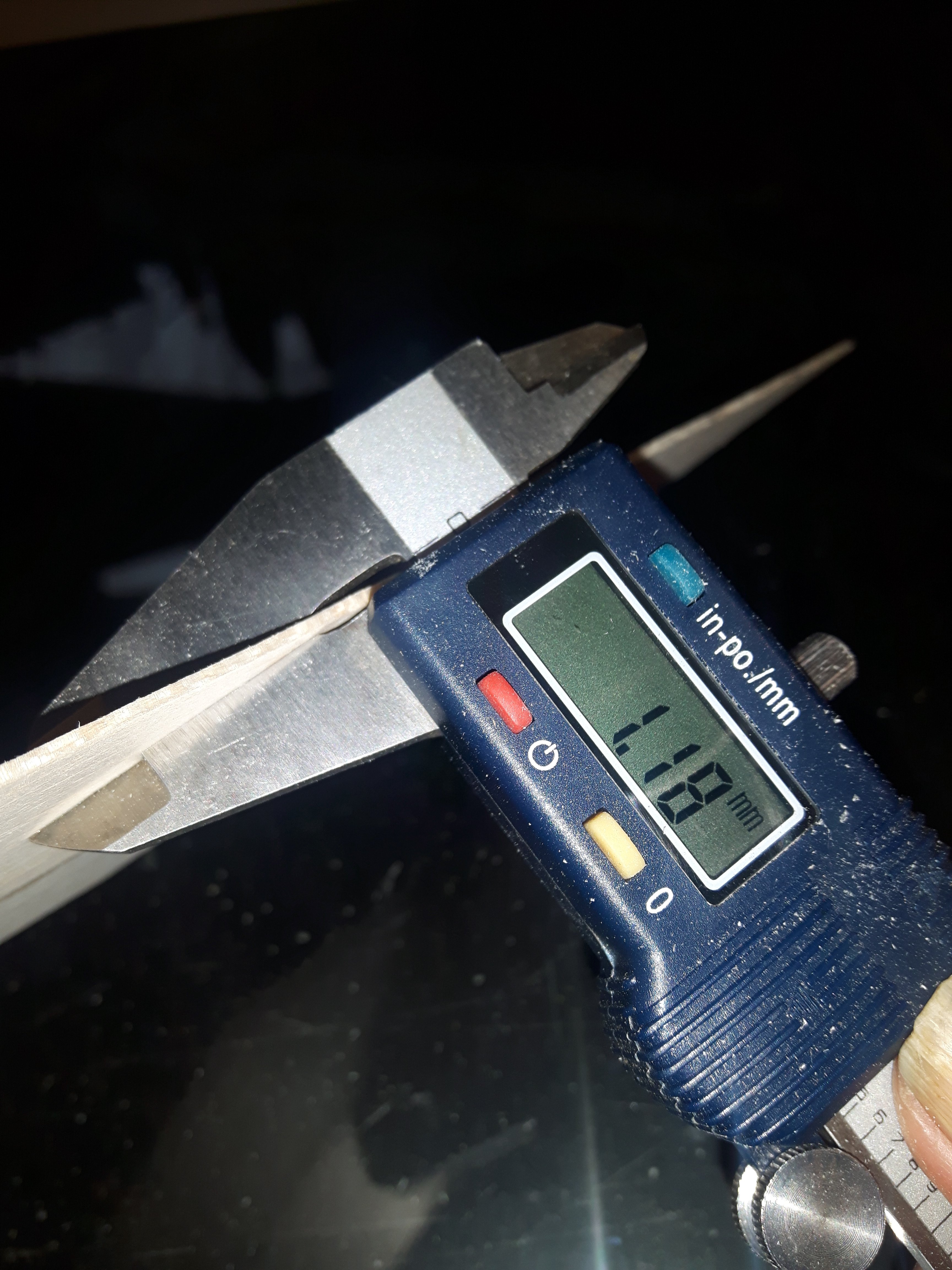

    A few picks of the crazy thin balsa sheeting... 20201123_130516.jpg 20201123_130516.jpg

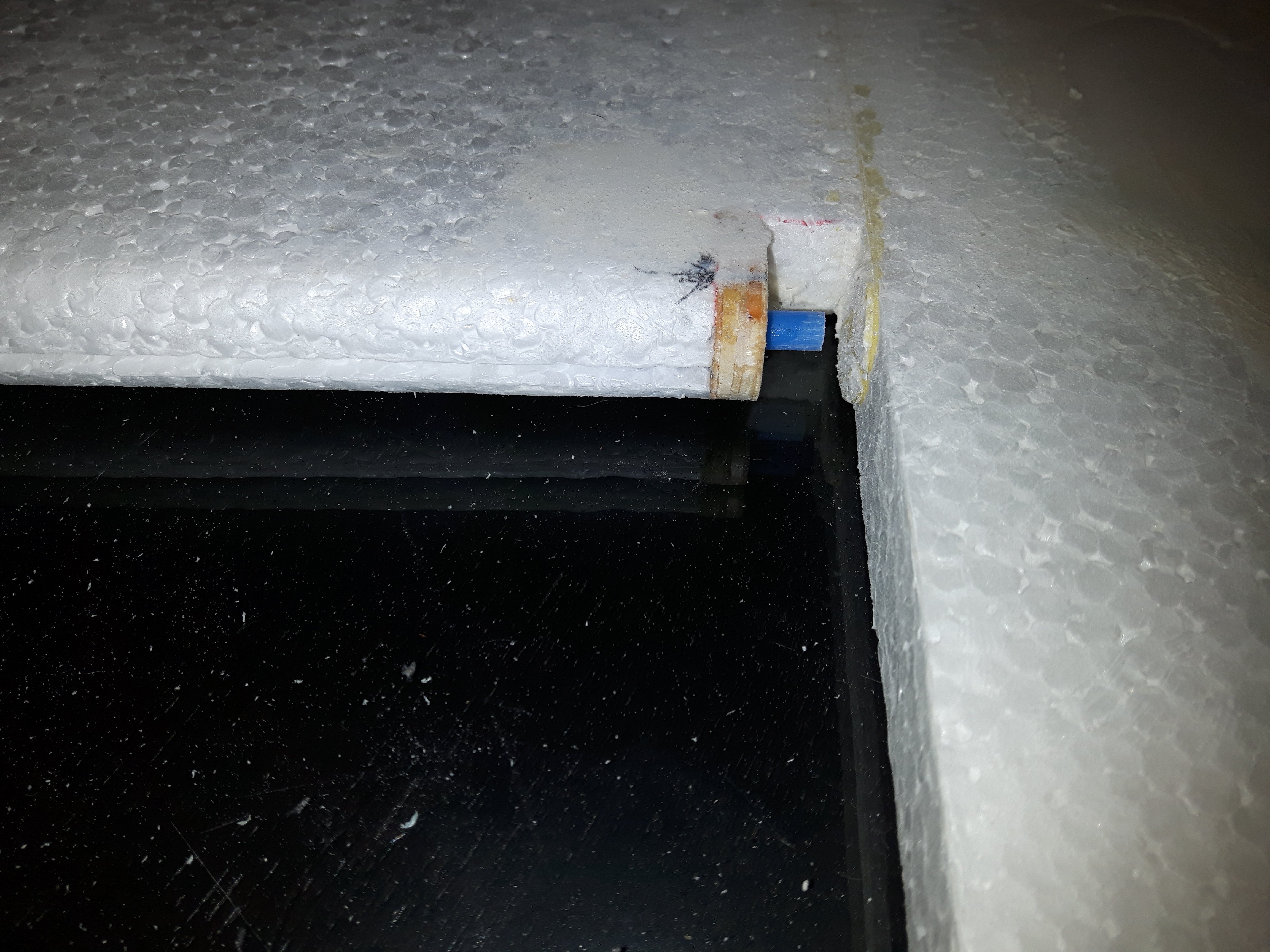

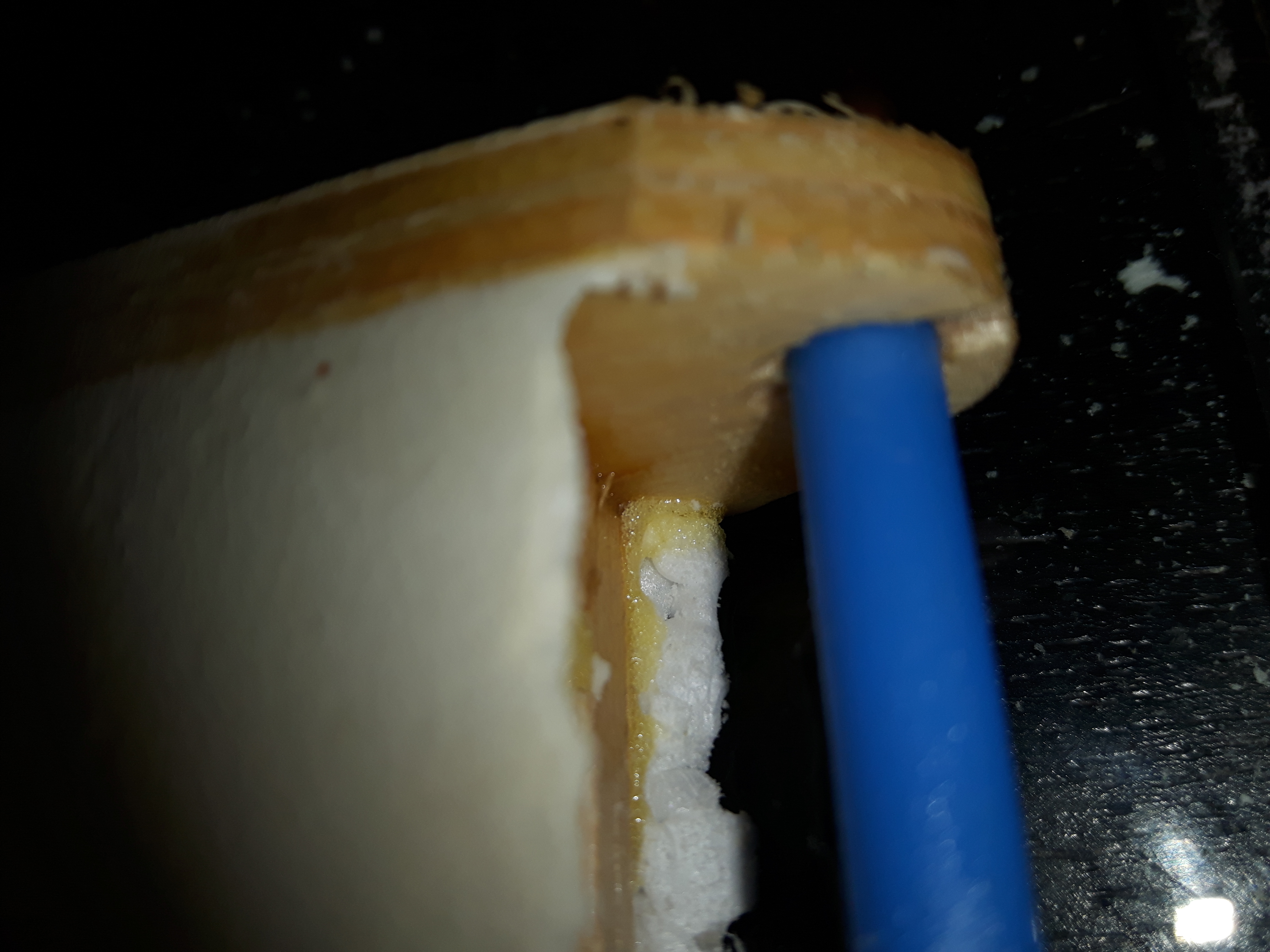

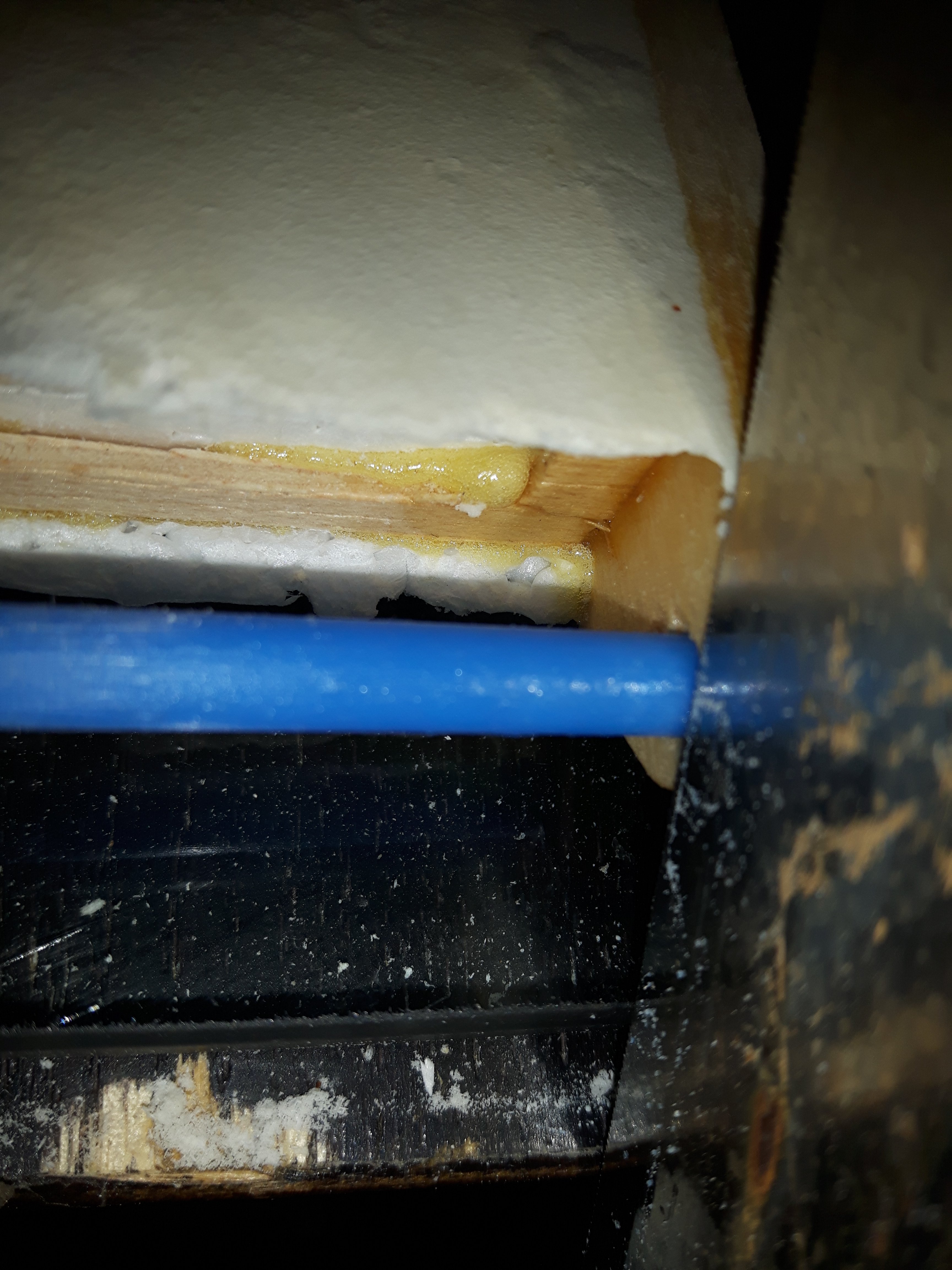

    I should add that the rudder and elevator were glued together before I received this kit.

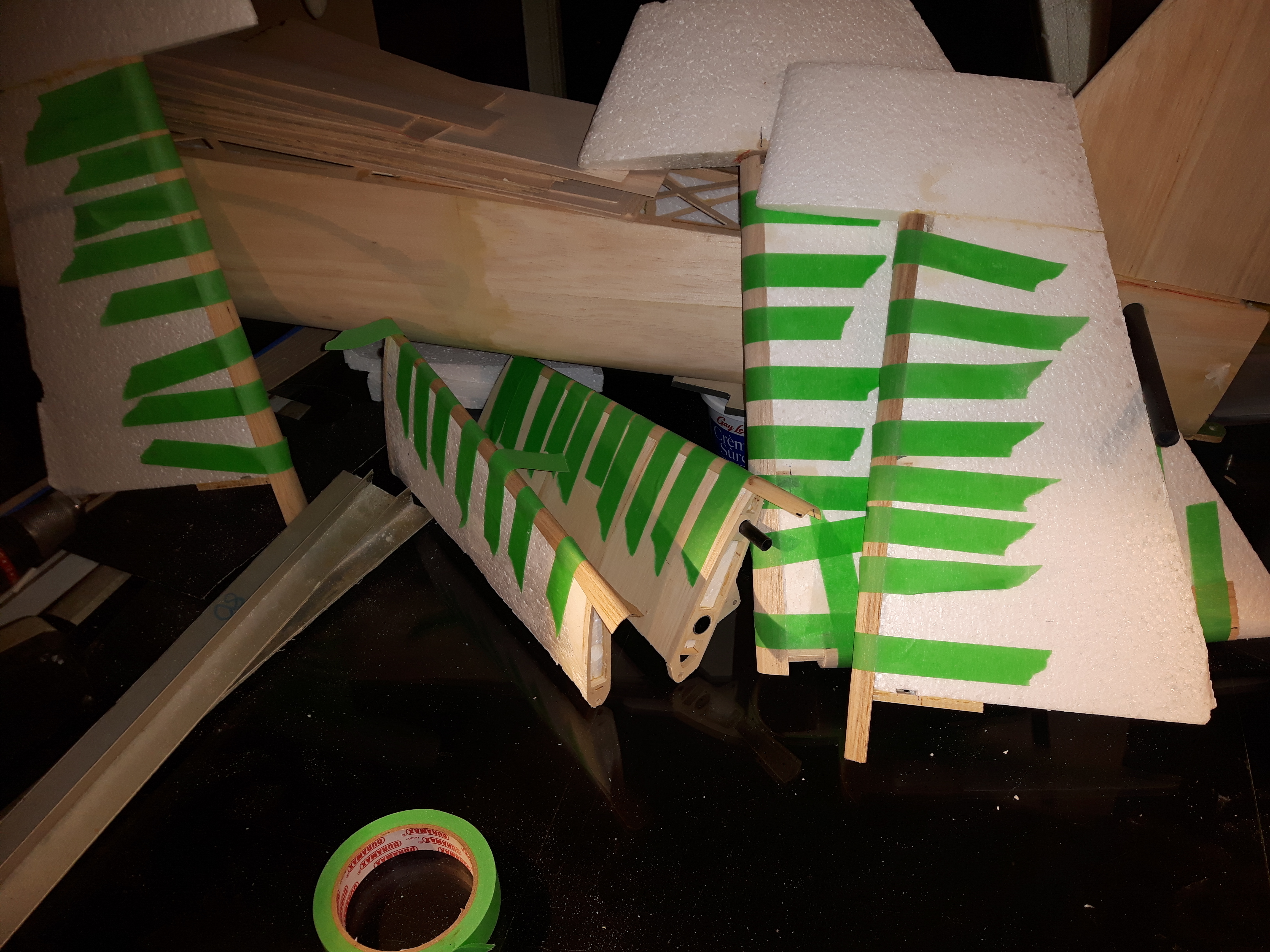

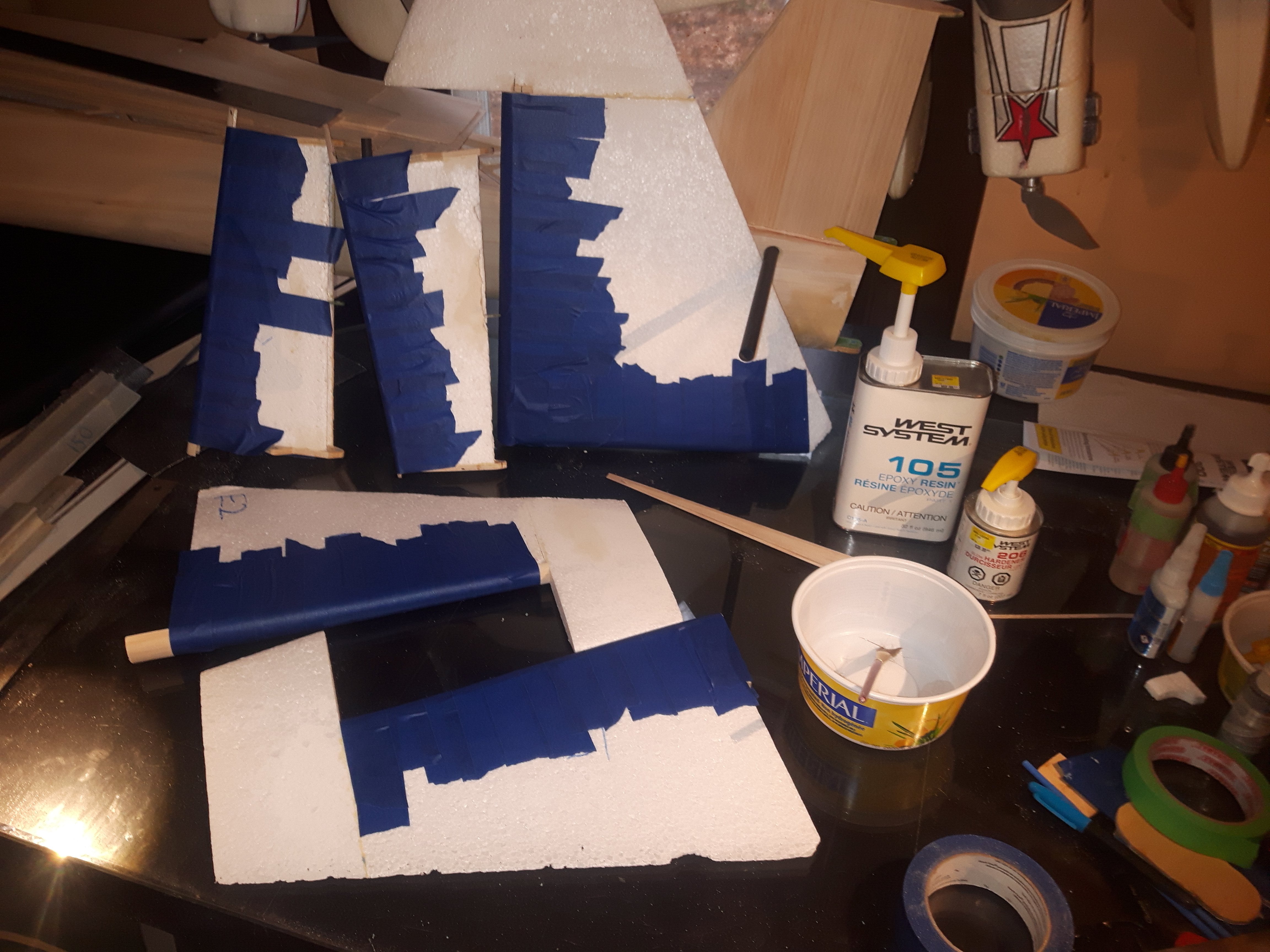

    Using the west system to glue the lead edges on, waiting for it to dry. 20201121_143545.jpg

    For this type of kit its nice to work on a glass surface, easy to scrape the glue off! Cause I'm good at making a frigging mess!
