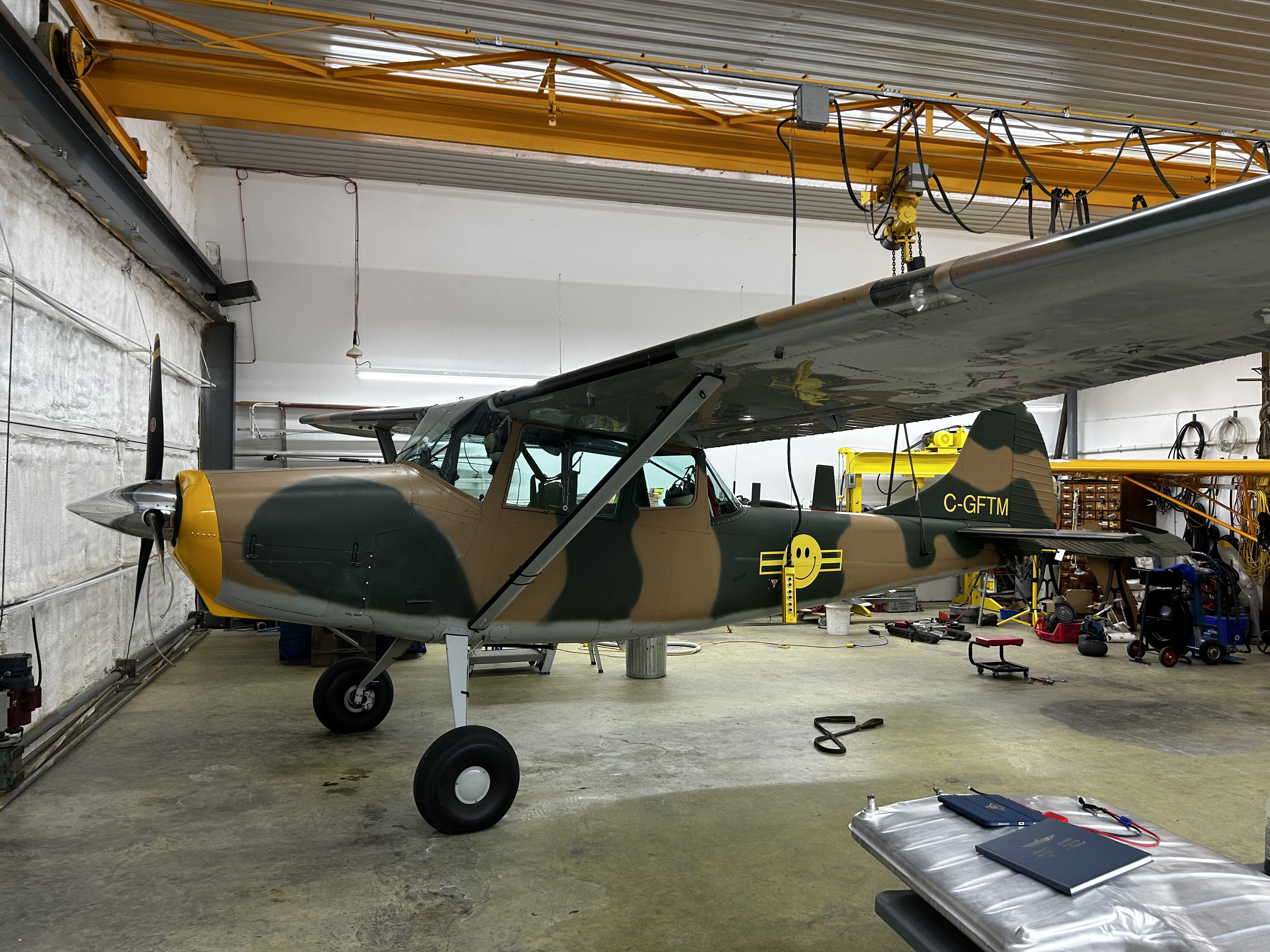

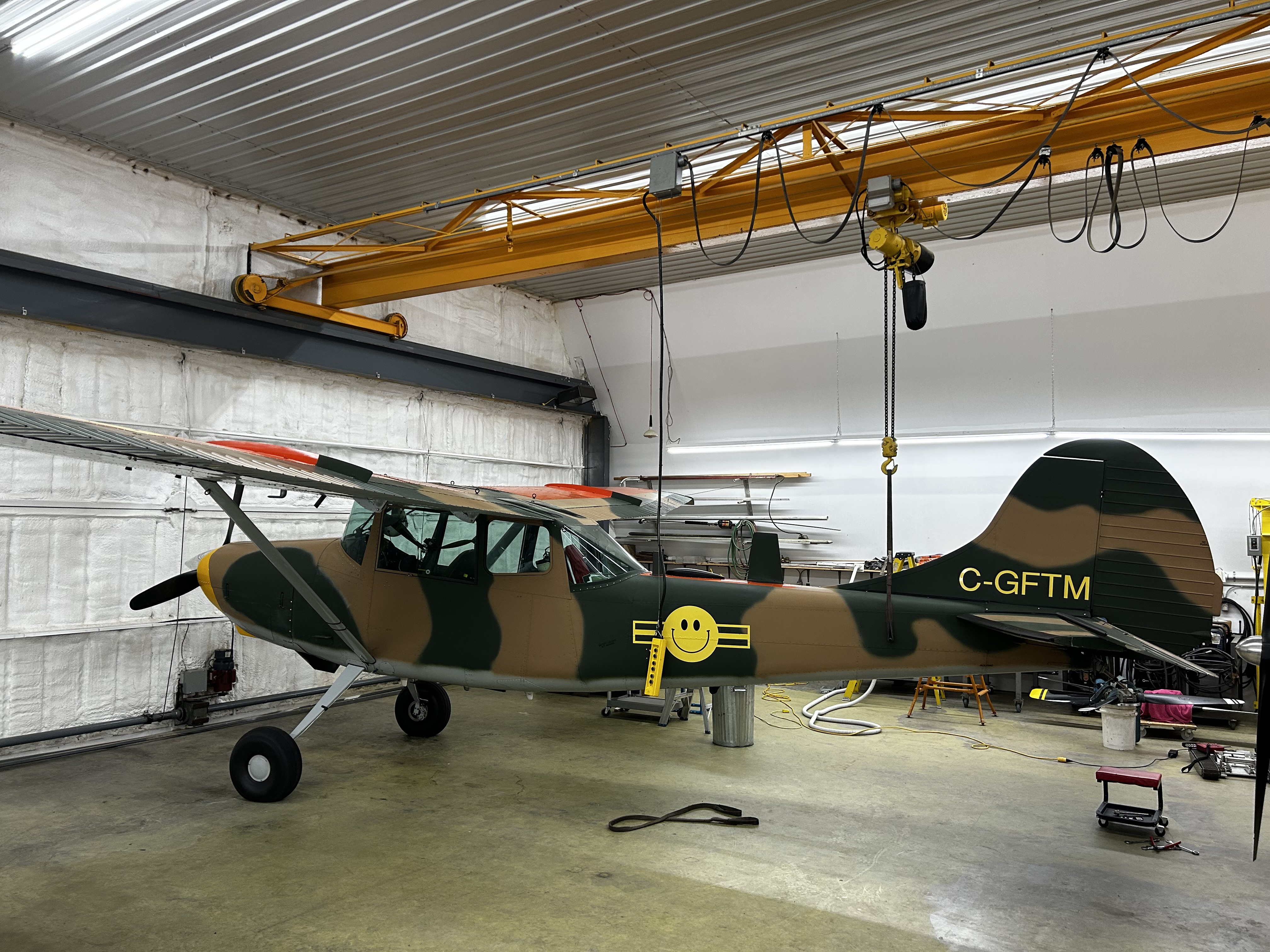

Who doesn’t need a crane in the hangar???

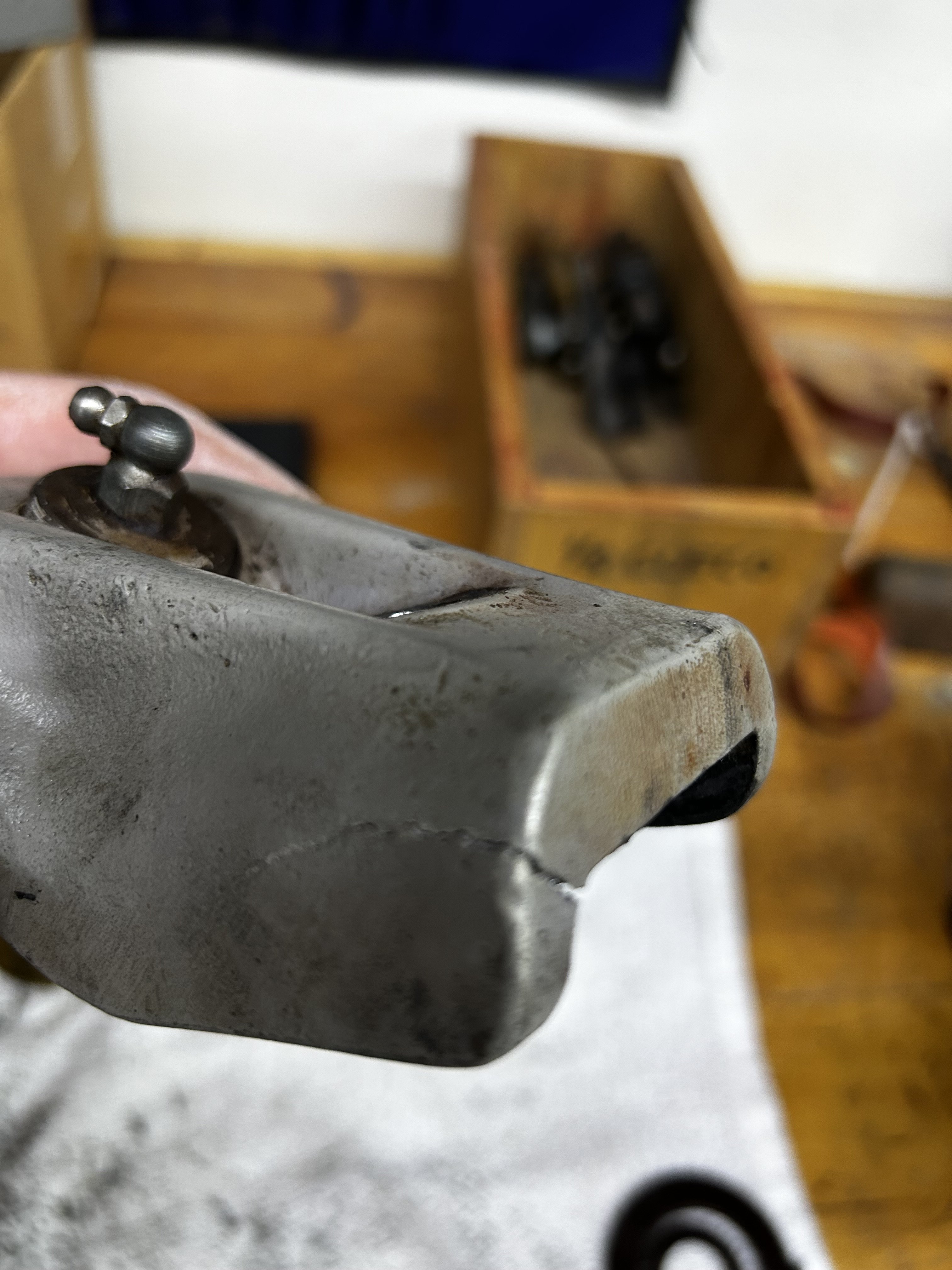

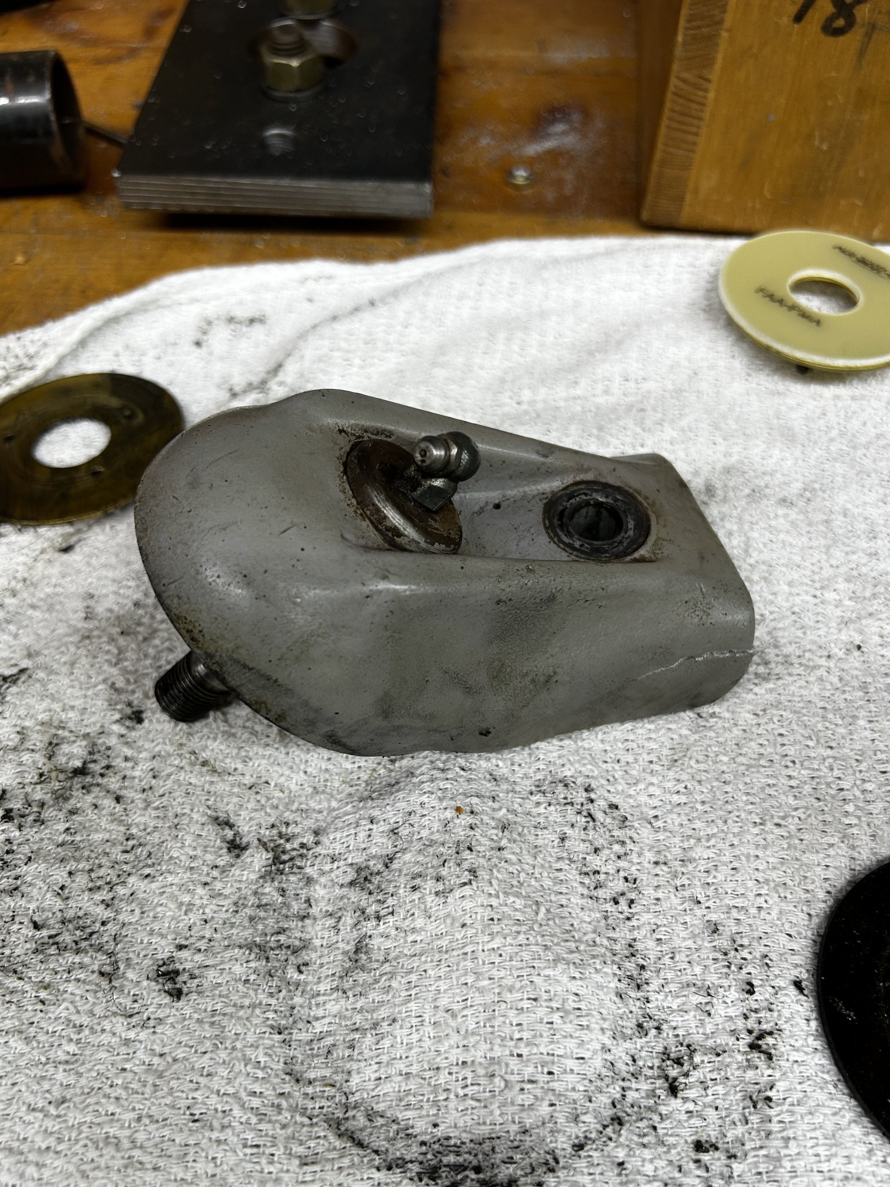

Flying a friend‘s L-19 and the tailwheel steering didn’t feel right. Pulled the assembly apart and found a cracked casting. :face-palm:

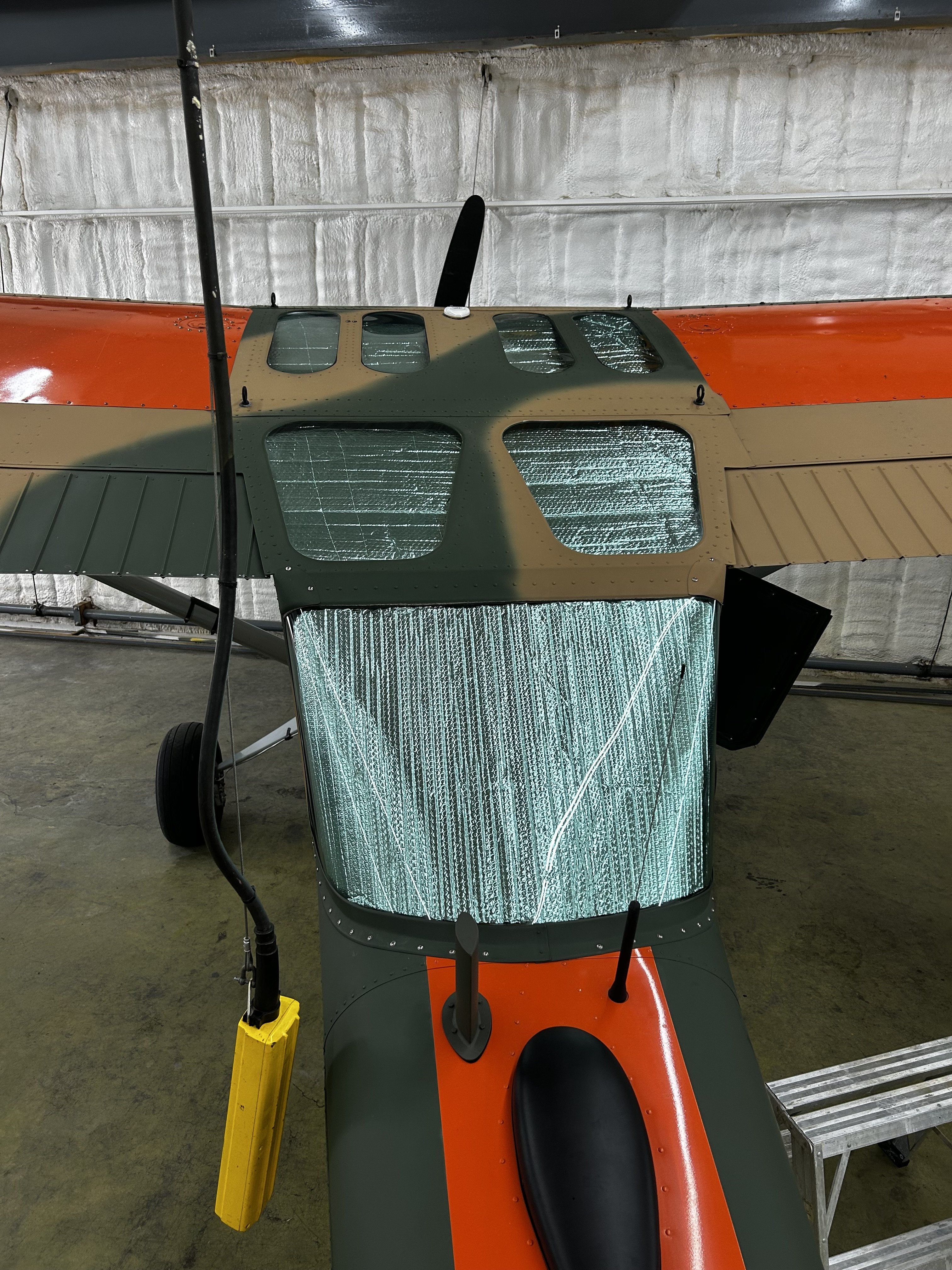

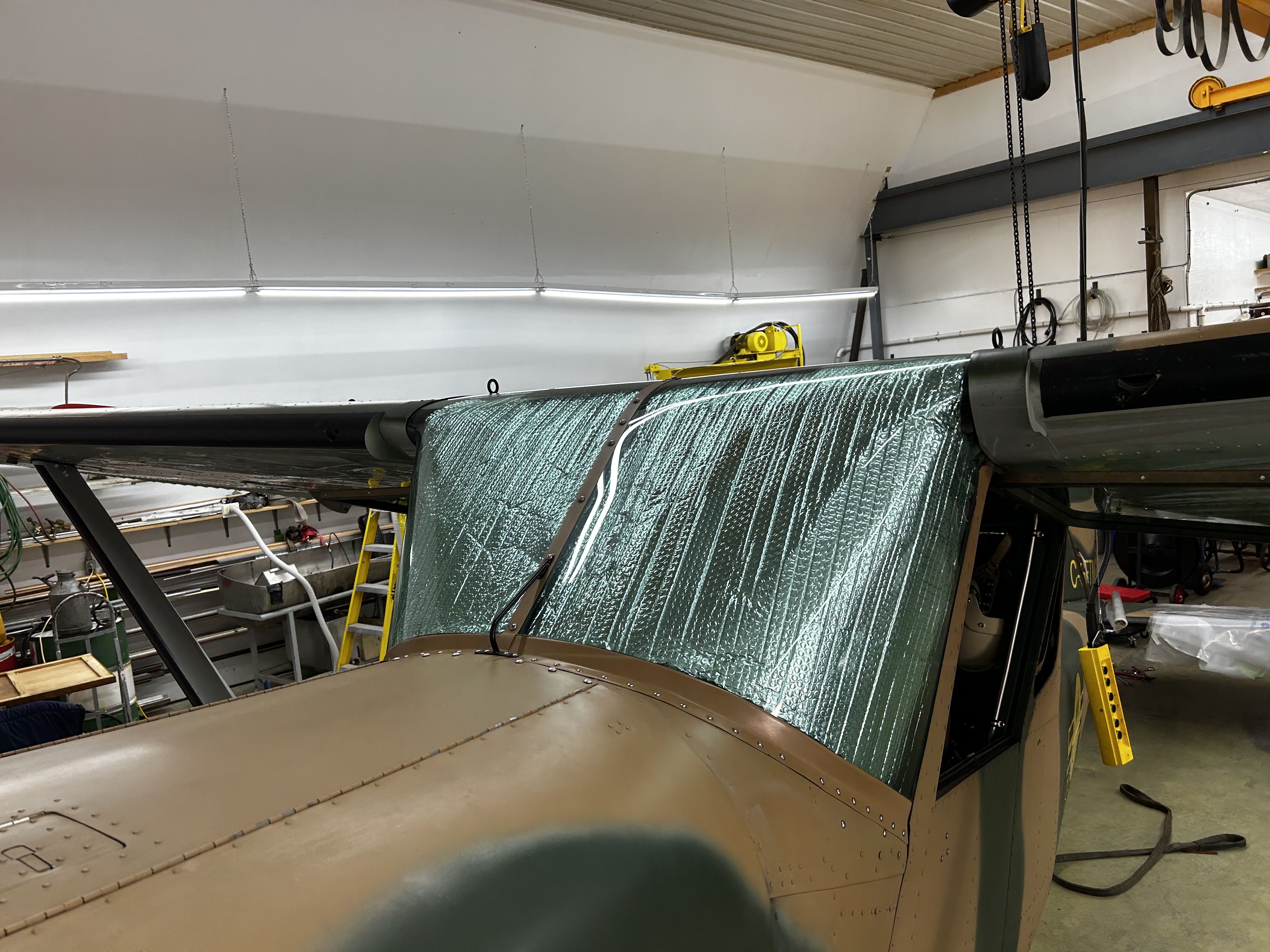

The airplane is going on a trip into the Yukon Territory and needed a set of sunshades since it will be parked outside for a few days.
Clear plastic was used for the various templates. Final pieces fit with no additional trimming required.

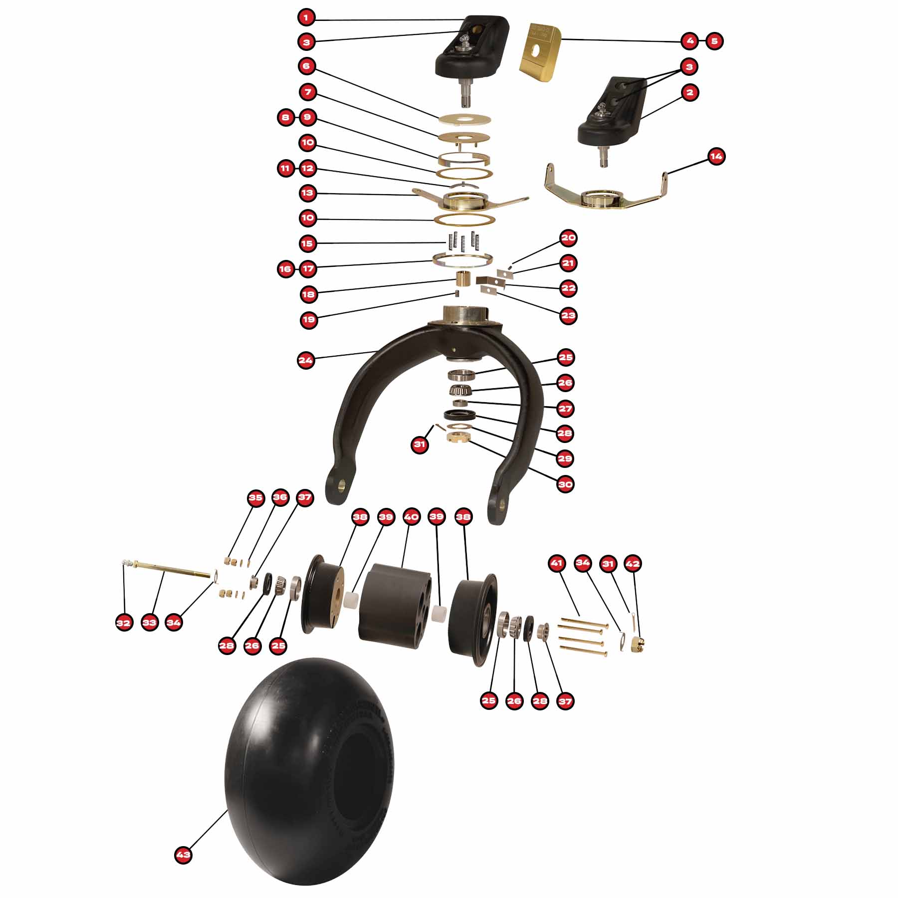

One bolt along with two spacers hold the casting to the spring. All four parts along with some of the internals were replaced. Better than new now!
Image courtesy of McFarlane Alaska HERE

Apparently someone had incorrectly assembled the tailwheel before the current owner corrected it. Easy to see how this could happen, but also may have contributed to the cracked casting.
