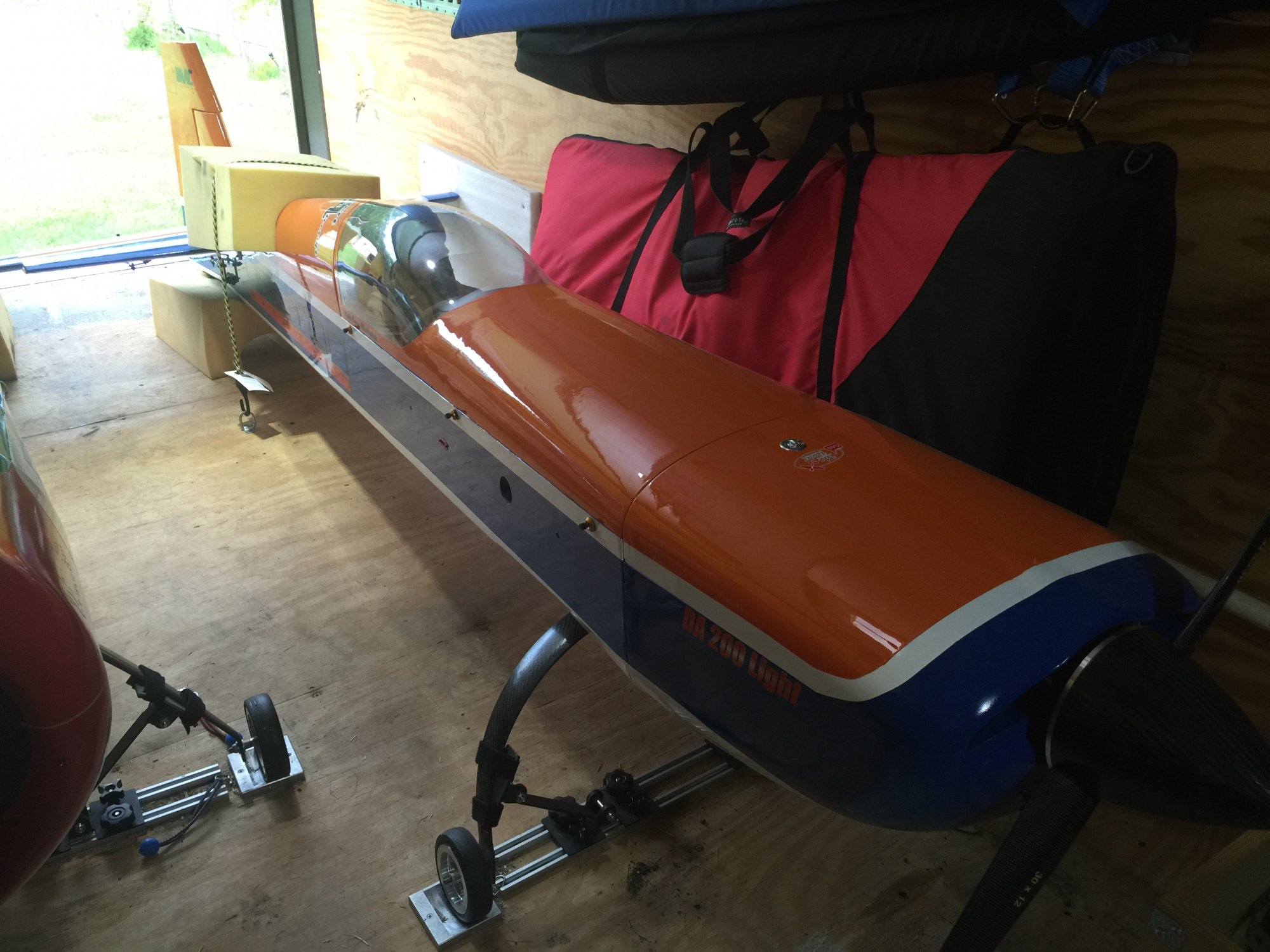

She is all loaded and ready for tomorrow.

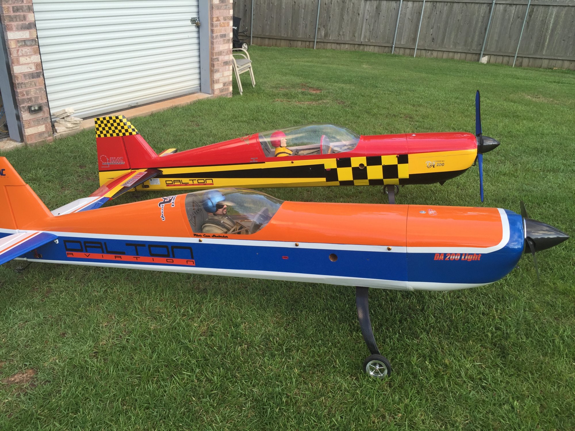

I placed the 300 ML next to the 300 SP, and compared them.
With the canopy on, and neither with the battery packs, I picked each one up, one at a time, by the wing tube holes, and both had same exact attitude.
This tells me, that it should have the same "balance" feel as the 300 ML, which has over 330 flights.
SO I should be in safe zone for CG. I am guessing, she will be slightly nose heavy.
On my airplane, the CG point will be 1 to 1.5 inches aft of the leading edge of the wing tube.

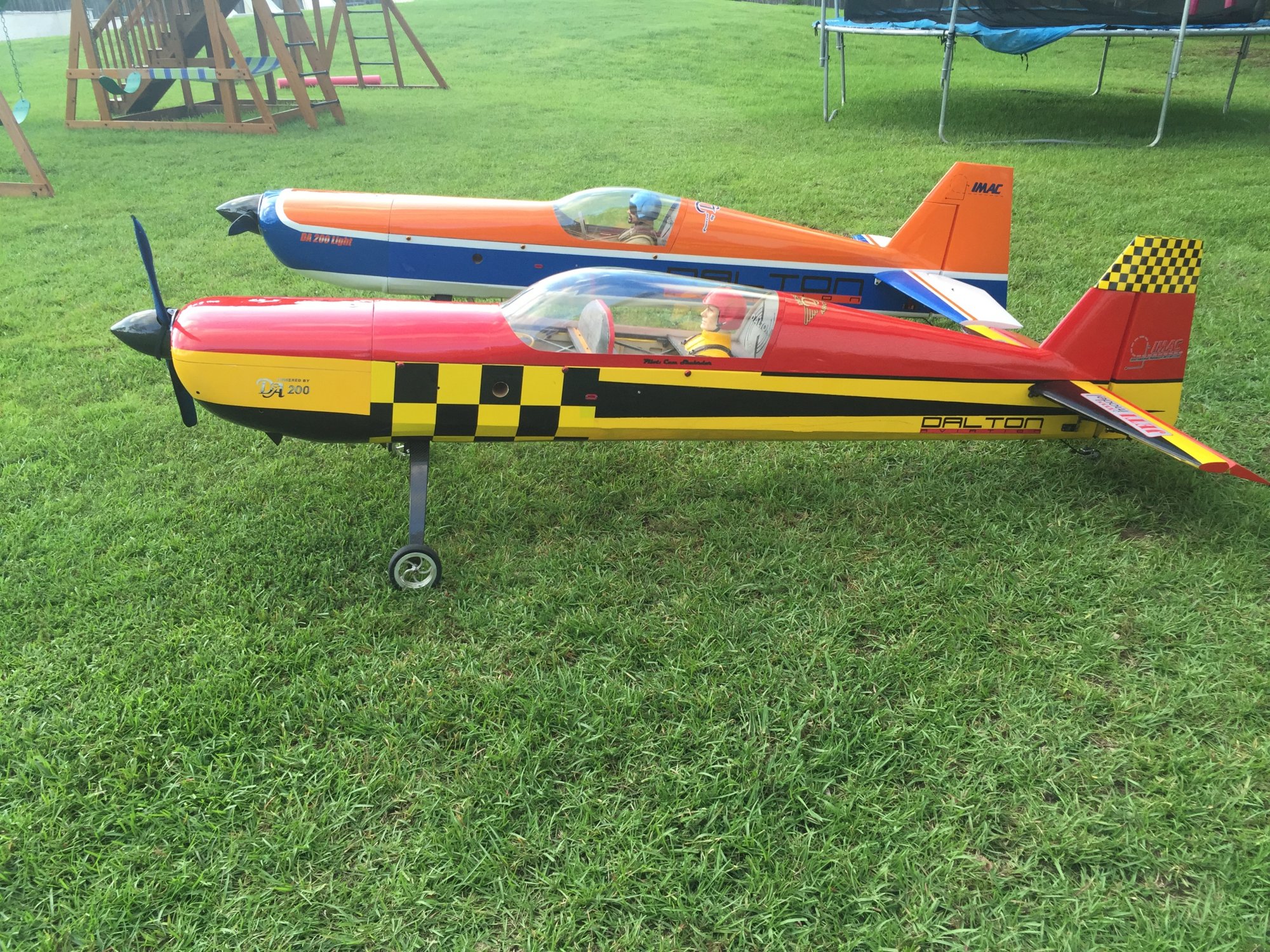

Side by side comparison...
on that 300 ML, it flies slightly nose heavy.
If I do the 45 degree inverted flight test, it stays in the trajectory, however, when I try to do a spin entry, the stall, if there is not much wind, it kind of mushes. This is how I know it is still just ever so slightly nose heavy. Not much!
