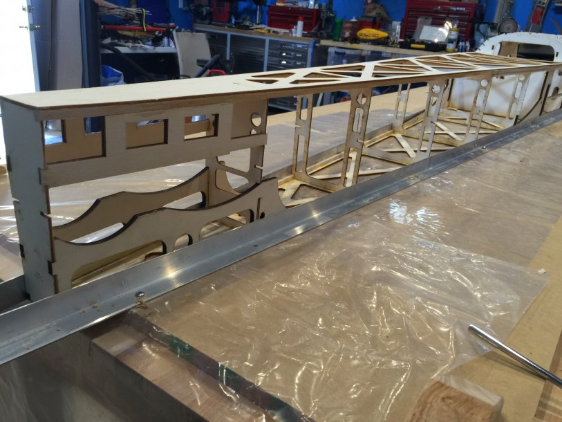

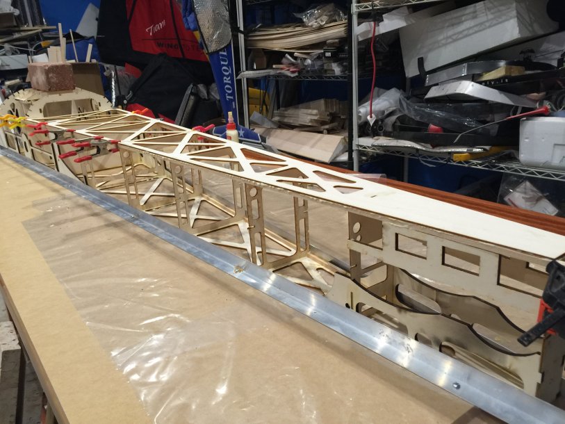

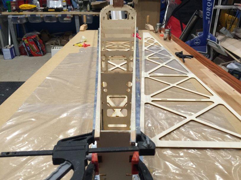

Early this morning, 5:30 am. I spent one more hour. I was able to place the formers (F4-F7) and glue on the stringers and the bottom ply brace.

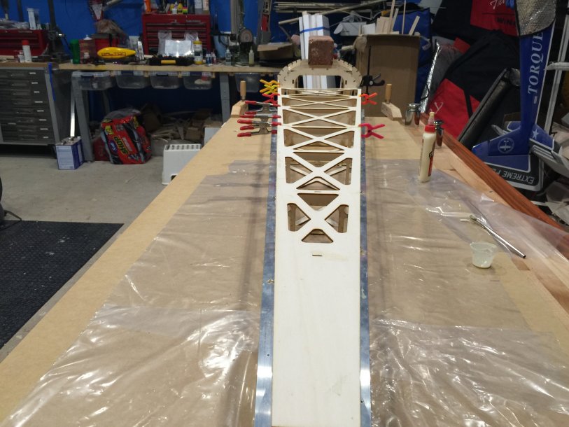

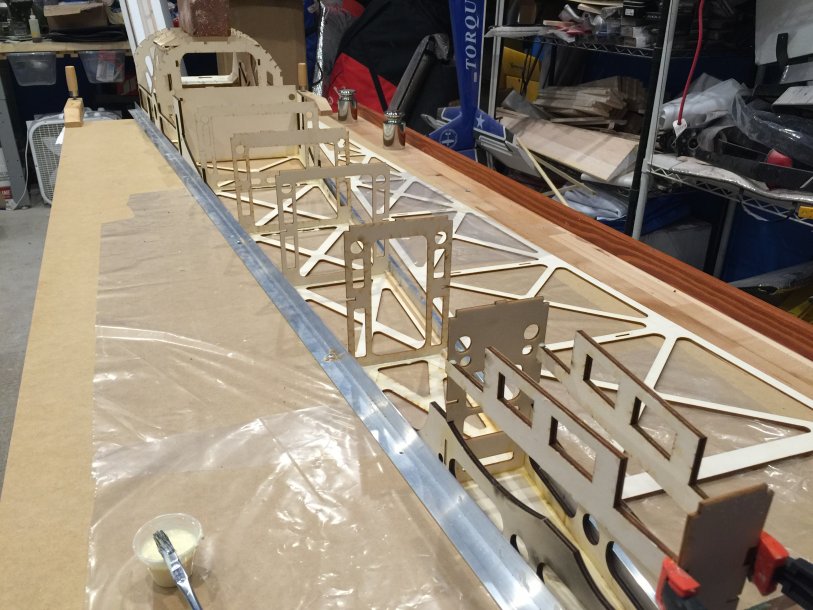

Placement of the servo rails in the tail segment, and the remaining formers.

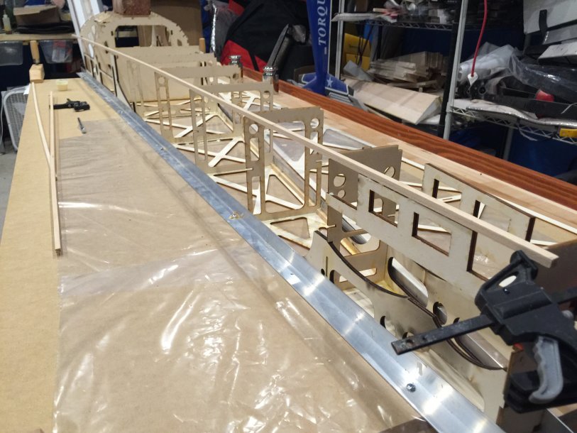

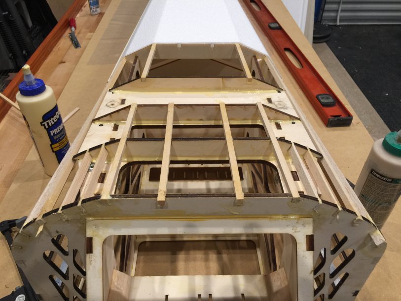

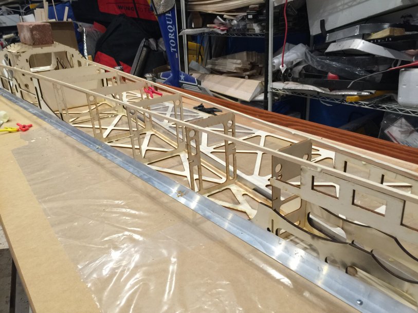

Placement of the stringers. There is one full stringer from F1 to F9. there is doubler from F1 to the front of F5, but not engaged into F5.

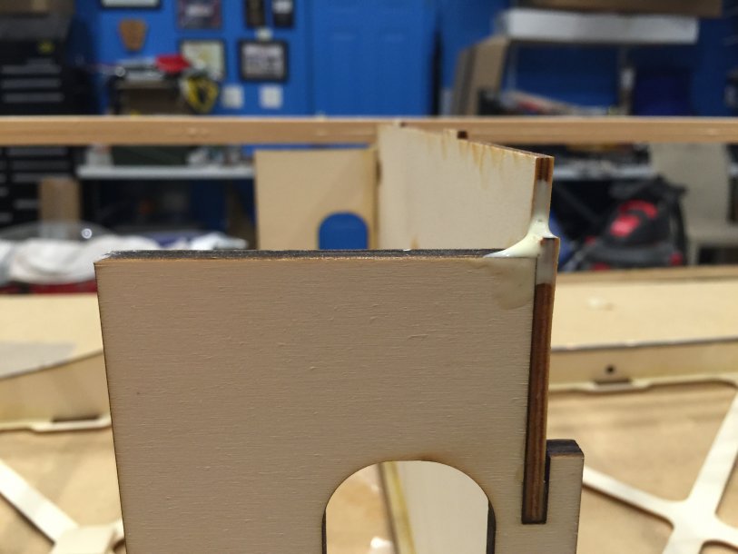

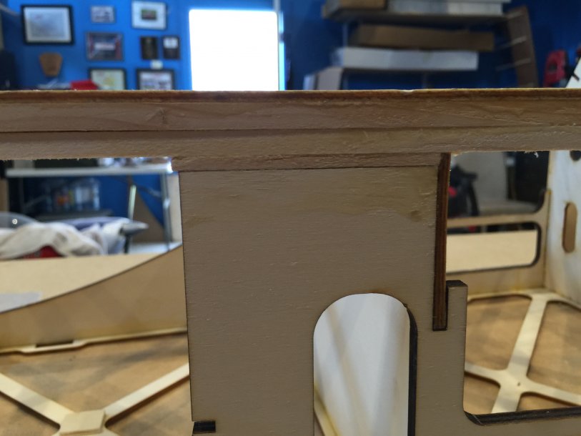

There is a tiny gap between F3 and the Fuselage Side.

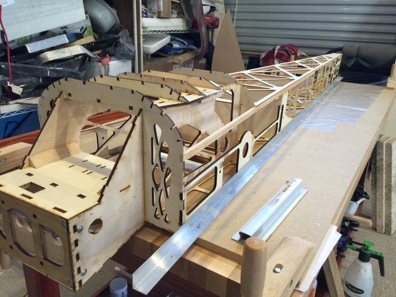

this is after placement of both stringers on both sides, and right before placement of the bottom plywood brace cap.
This is best done with an assistant.

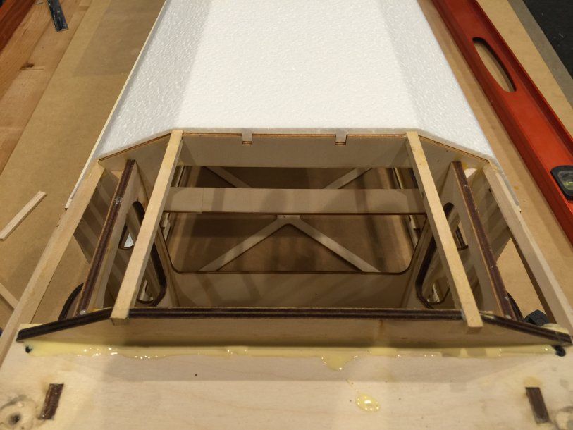

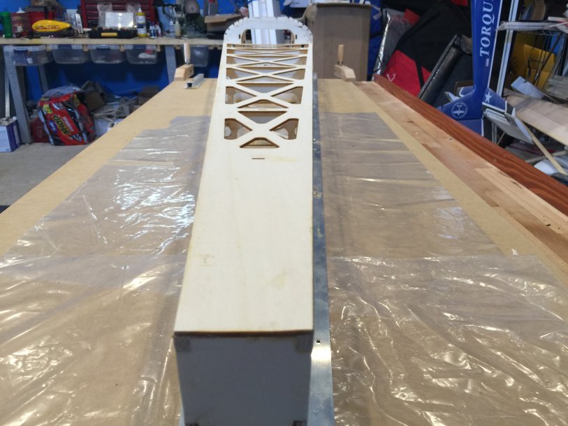

here is the plywood bottom brace cap on. SO easy!! just snaps into place.
after this step, time to wipe off all the extruded glue and place clamps everywhere!

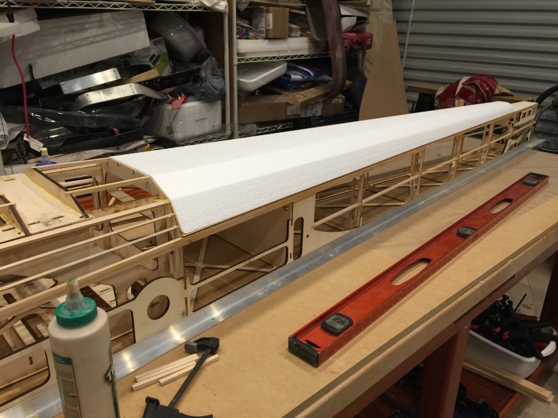

More has been done. About 20 hours total up to now.

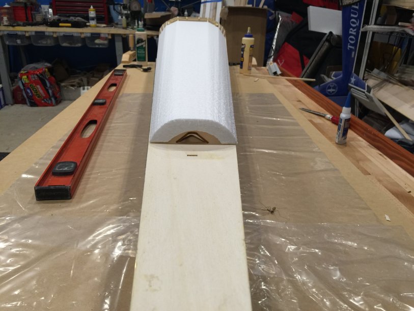

The foam belly pan is temporarily being placed just for estimate of the appearance.

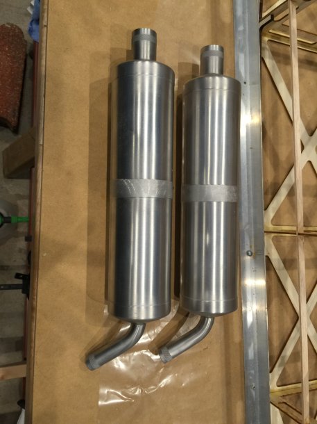

Additonally, i really like the placement of the supports for the 1/4" spruce on the gear plate, as this allows and exit for the stingers, if you are using rear dump canisters.

Cam,
It looks like this plane is not setup for tuned pipes, just canisters. Am I missing something? It just looks like there is no exit past the wing tubes and on my LX the RE3s exit past the trailing edge of the wings.
