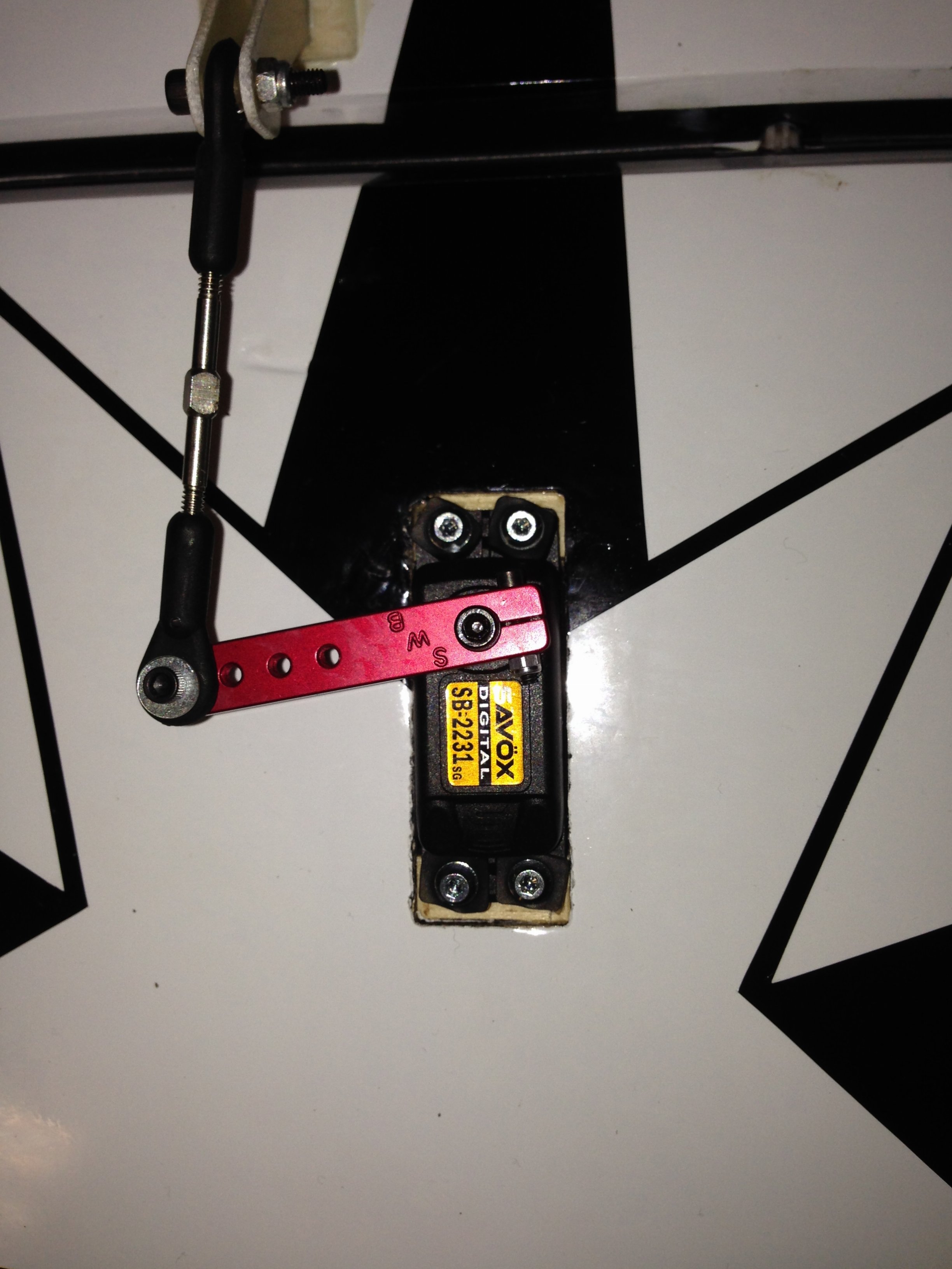

I am running these servos with SWB servo Arms: 1.5" on the 4 aileron servos, 2" on the elevators, and a 4.5" arm on the two rudder servos.
Prior to mounting the servos I decided to do a test of the current draw on each of the servos: I mounted a 2" servo arm, plugged the servo into a JR match maker powered by a fully charged 2 cell lipo with a Hangar-9 inline current meter. Putting as much force on the servos as I could with my hands, the servos only peaked at 4.2 amps.
