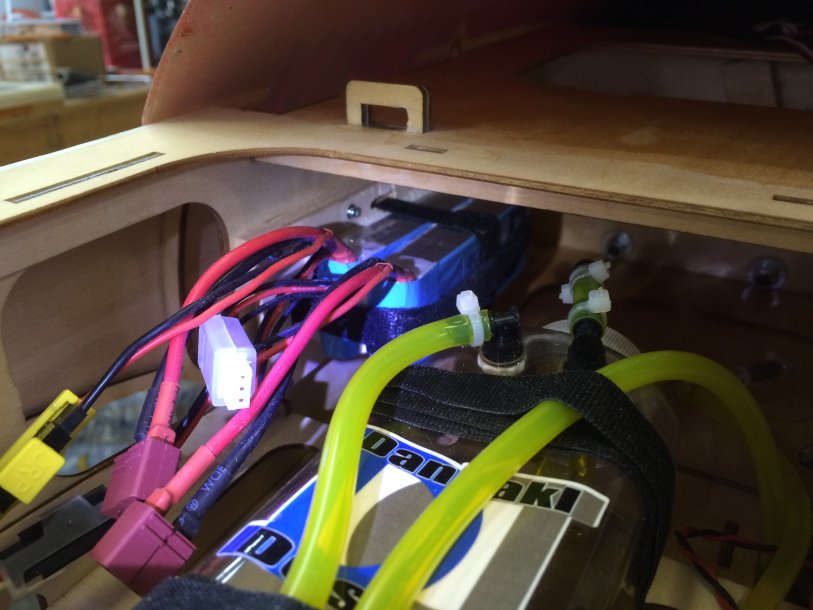

I got out on Tuesday and had one great flight. I made some changes to the CG. I moved the battery back about 4 inches. It seemed perfect at the beginning of the flight but I thought it was tail heavy towards the end. It was so close that I dismissed it. I refueled and started to take of when my friend Perry Vanmeter said hold up. Your muffler is loose. I turned around to check it and it was.
Let this be a lesson to you. The plane talks to you if you know how to listen. When I pulled the canopy off I found the batteries loose from their velcro straps. I should have known right away to look inside the plane but I didn't listen. When I moved the batteries I didn't have the straps tight enough so the batteries slipped out from under them. I did a poor job moving them. I thought it was good enough but it wasn't. Now I made a new battery tray and have it strapped in there pretty tight but I have to wait to fly it to check it.
