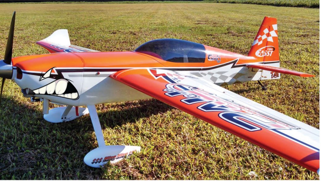

PAU 30% Edge
2robinhood
I really, really like mine.
Bipeguy03
I want another 50cc to bang around, I love my Extra for that very reason. Plus they are small so someday when I get my Pitts built I'll still have room in the trailer.
It's between this and of course the Challenger ;)

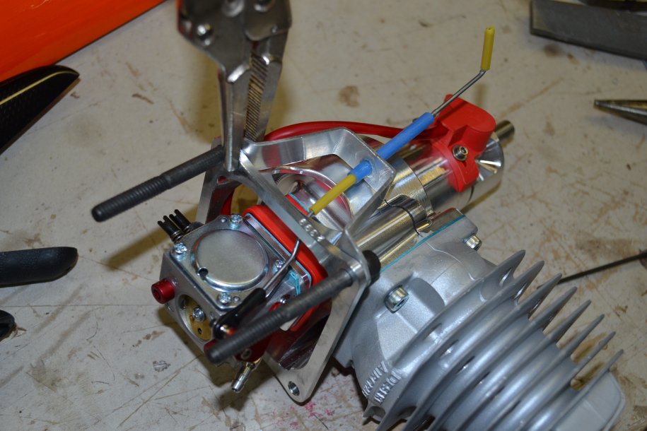

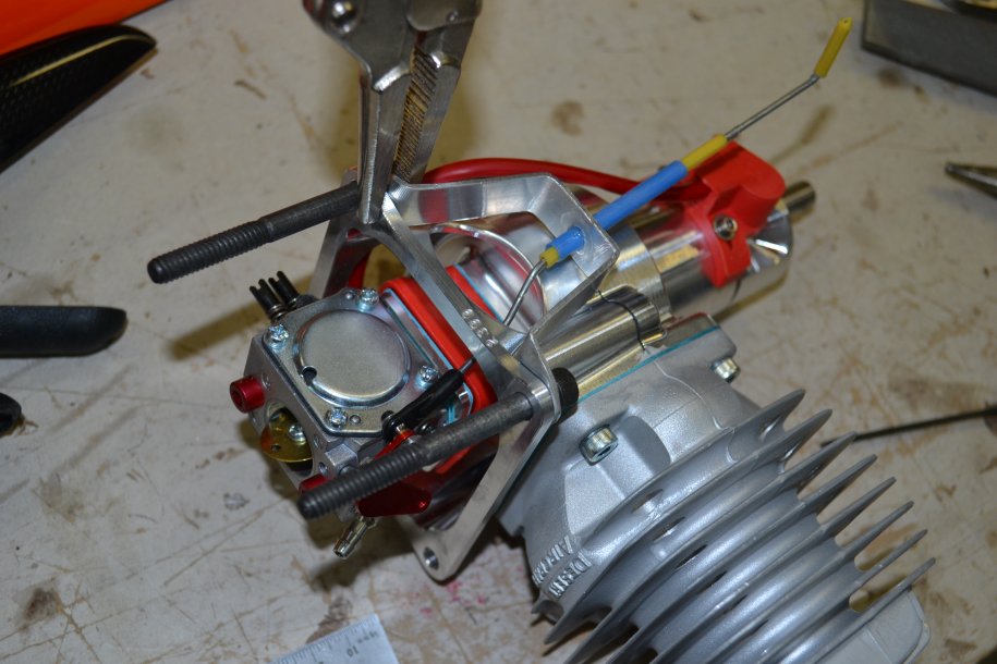

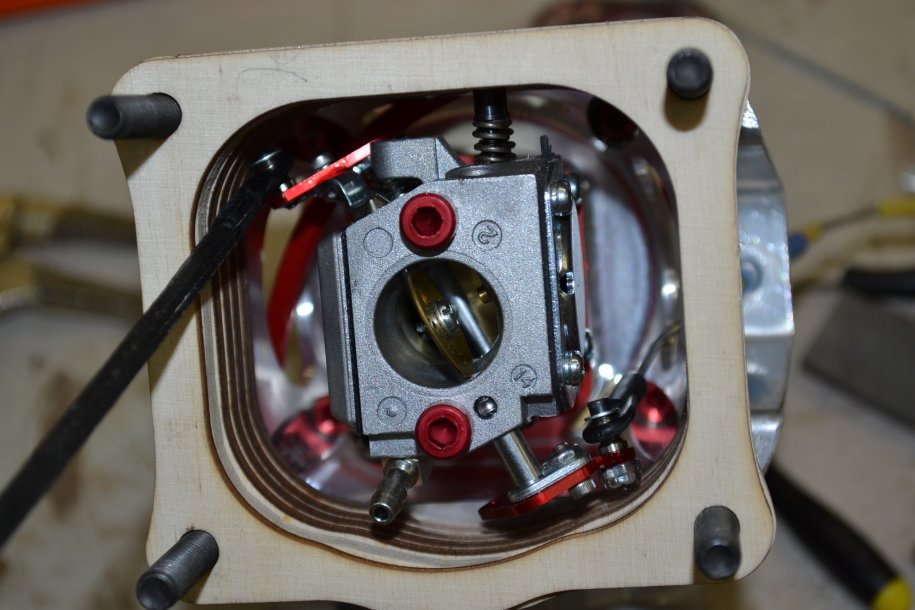

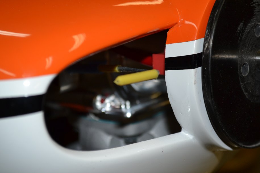

I had to get some 2-56 rod to make up the choke setup. Made a new bracket also. One more step complete. I was hoping to get this finished up last weekend but things didn't work out. Now I will chip away at it after work this week. I forgot how much little stuff I do to mount a new engine. I get finished with a step and I remember something else that I have to do.
I wish DA would start putting Jr plugs on their ignitions. That would save me a step.

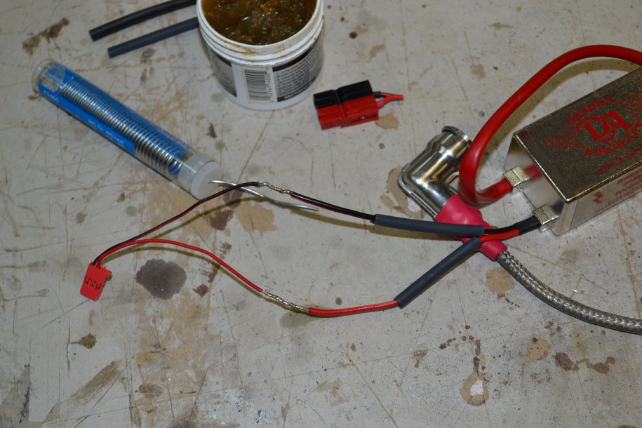

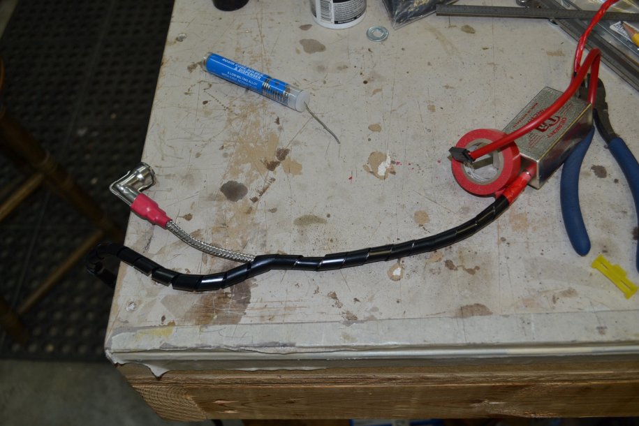

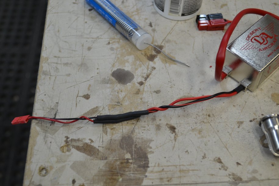

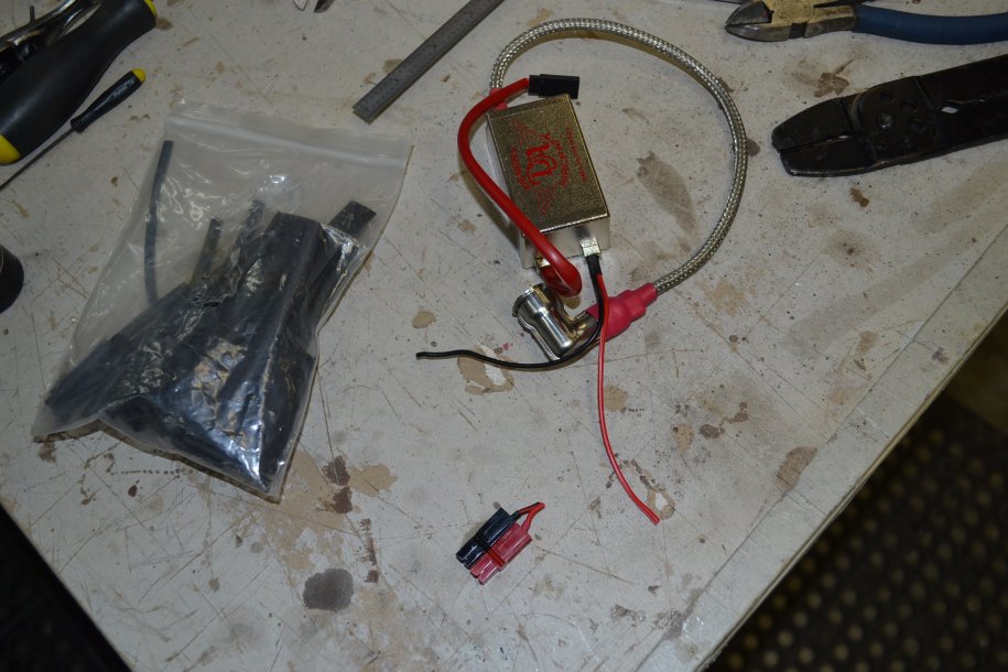

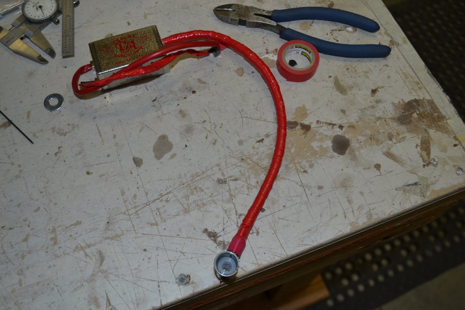

Have the ignition ready to install. Soldered on the JR connectors and put spiral wrap on to protect the spark plug wires. I wrapped the spiral wrap with electrical tape. The tape helps keep the spiral wrap from spreading out.
