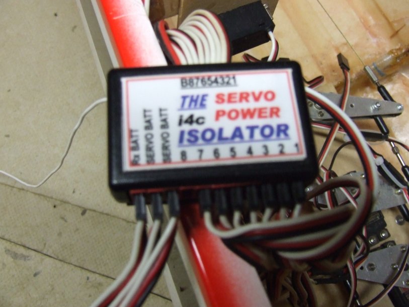

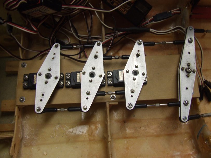

I just got a friend's 3 W Patty Wagstaff Extra & need advice with just about everything, Ha !! First off, it has Hitech 5945 MG coreless servos, only 180 in. oz. of torque. It has 3 for rudder, 4 for elevators & 6 for ailerons & some other servo for throttle. I guess that was 9 or 10 yrs. ago they were installed but only made it in the air & the DA-150 quit, busted the landing gear block out a little but am repairing that & it never flew since. Can these servos still fly it ok ? I believe I need a Smart- fly system for it as it has some type of I4c power servo isolator in it now. Appreciate any advice !!

I have the same servo setup in a comp ARF Extra and it flies fine. Not for high energy stuff but in its day, that's what they used. Just make sure you have a good battery source.

This size plane will be easier for you to fly which means you will begin to do more 3D. Those servo's may work fine now but in my opinion will be a risk to use as you fly harder.

js-rc
Thanks Sweetpea !! I'll be using a Futaba 10-C . The plane has one of those 8 ch. I4C servo isolators in it. Don't know a thing about it though, so I was wondering how to get all the servos in sync so they don't drain the batteries. I don't have the instructions for it either, that's why I thought I'd get the SF . Now without a SF would I have to get a Hitech programmer & program each servo ? I had one once but it was over my head trying to hook it up to the computer & all so I canned that idea, ha !!
