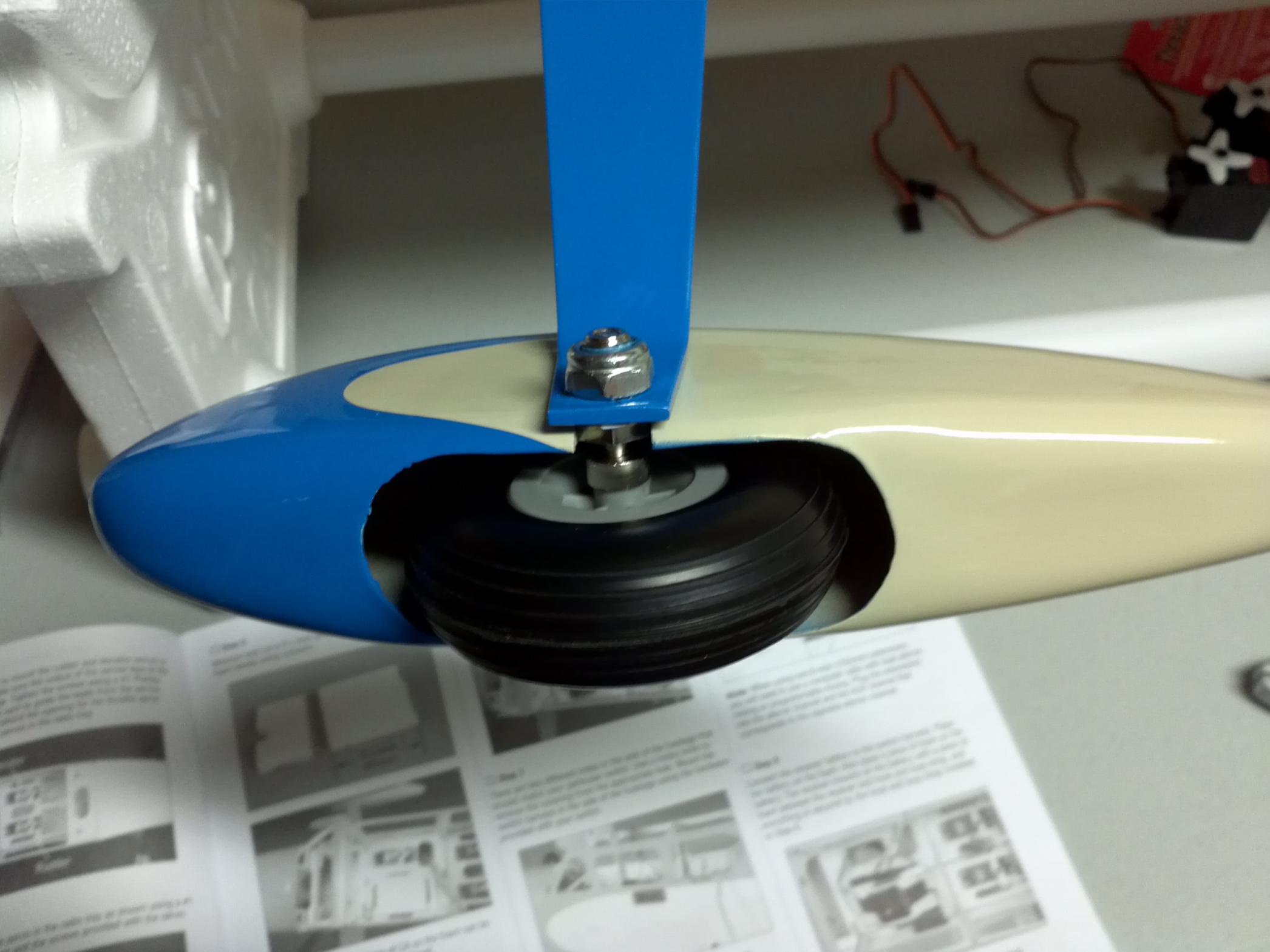

Really liked the wheel hardware. Sturdy and of great quality. Assembly was a snap:

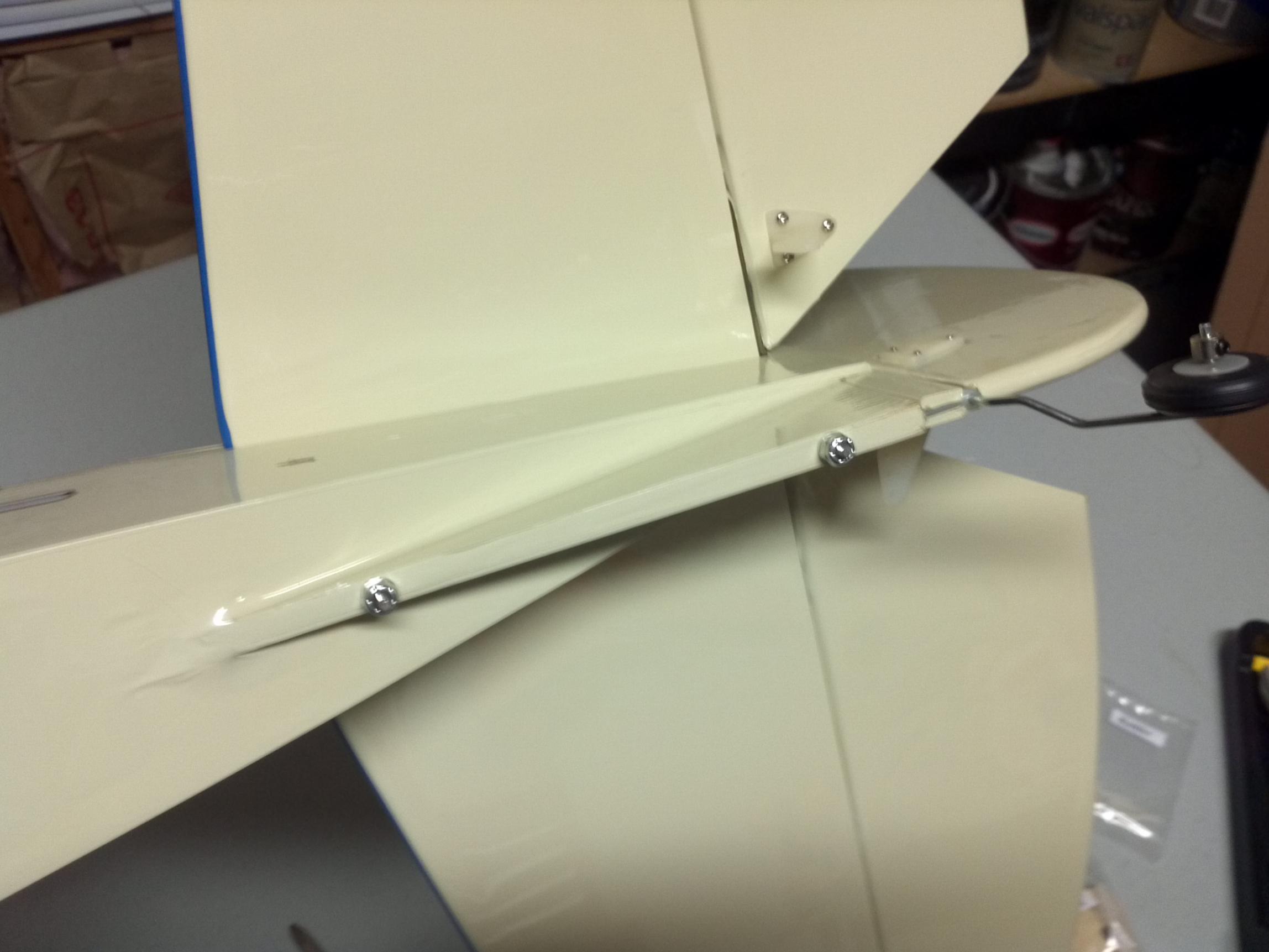

Horizontal and vertical stabilizers installed simply by sliding threaded rods attached to the vertical stab through the horizontal stab and through the tail and affixing with lock nuts and washers:

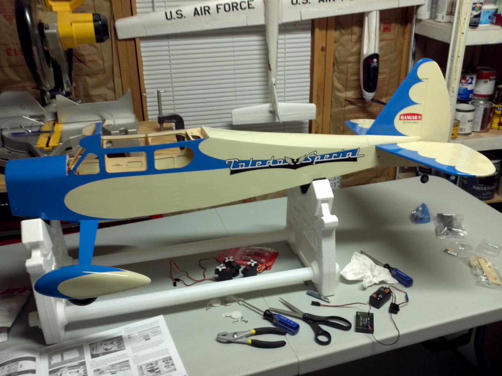

Plane so far:

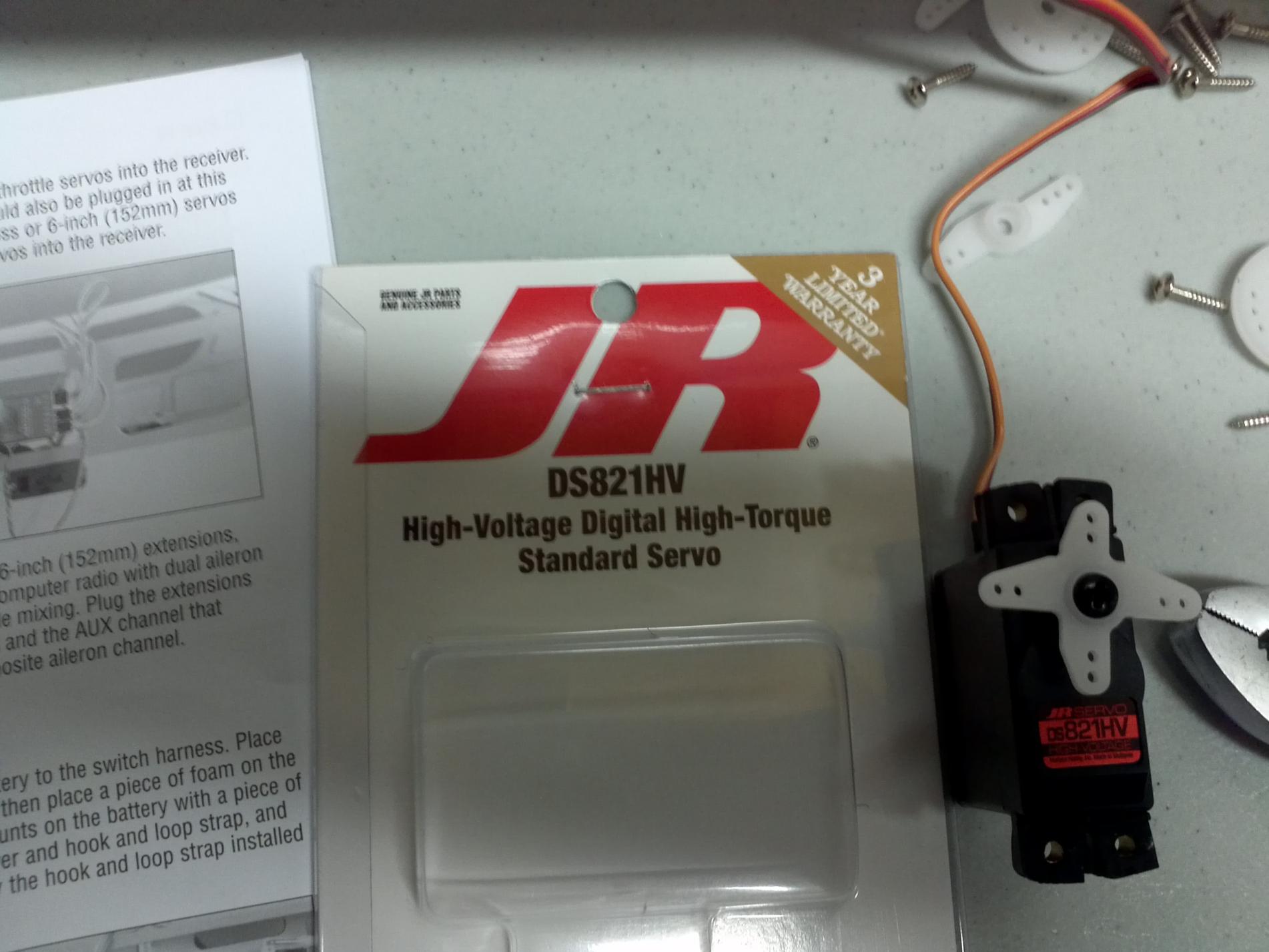

High voltage digital JR servos I'll be using (no BEC baby!).

Remember, BEC means Battery Elimination Circuit. In the case of rpstar's Toledo Special, he WILL BE using a (rx) battery...so he has no need for a circuit to eliminate it. He points out that he's using HV servos which is saying he'll be using a 2S lipo directly into the Rx and servos and thus not needing a BEC.

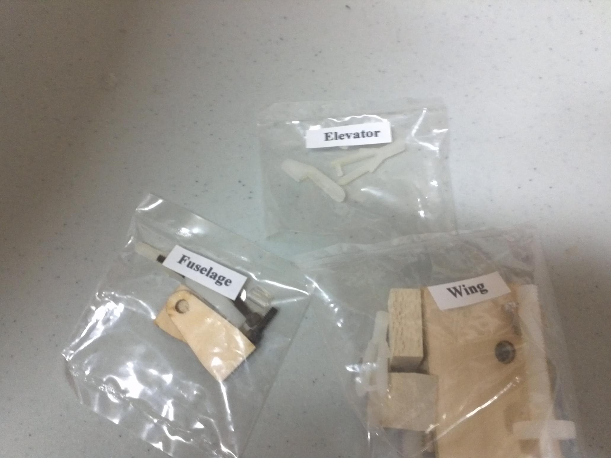

Example of the bagged and labeled parts. To me it's a nice touch.

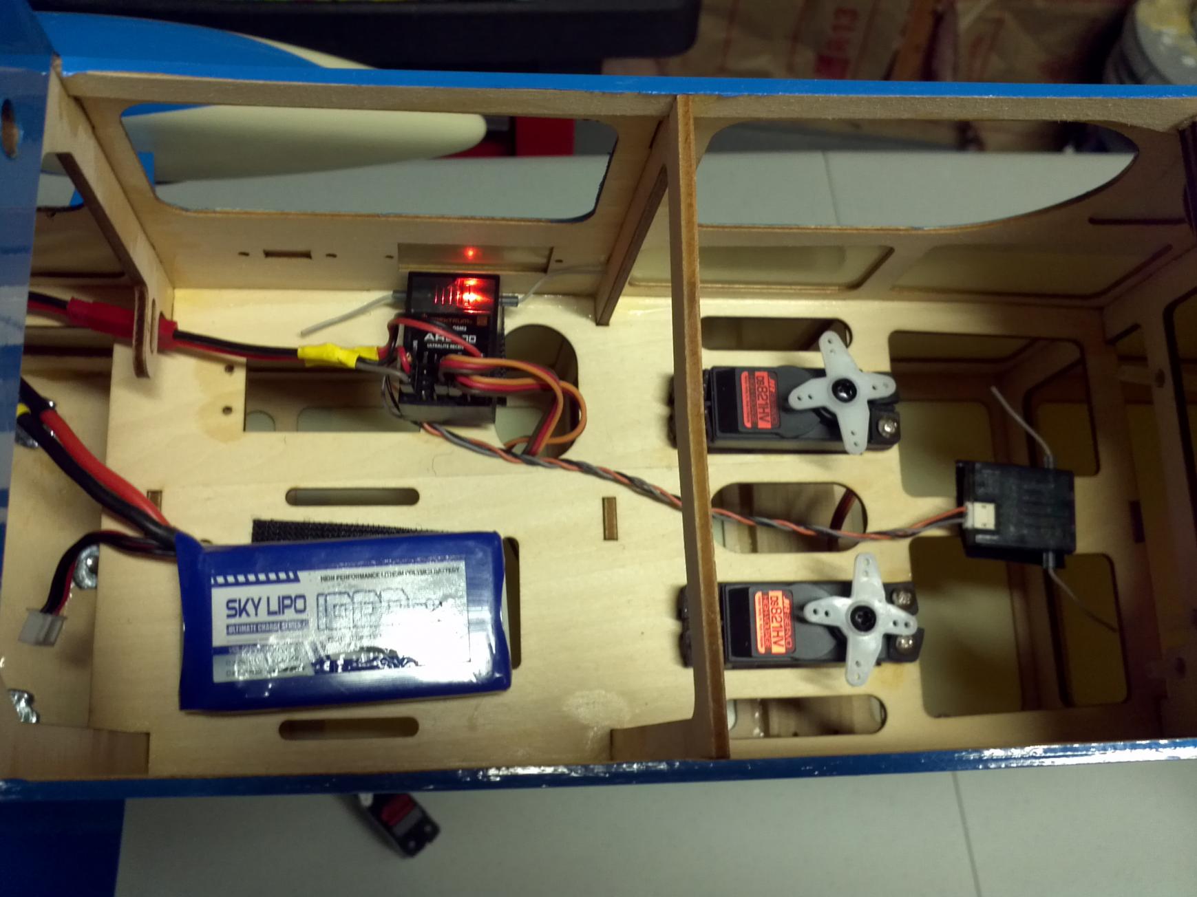

Today's progress.
I wanted to run all the power through the receiver but was concerned about the very thin wires on the servo connectors. Luckily this is a 6-channel receiver on a 4 channel plane so I doubled up the "servo" power connections to the battery and ran power into the battery and aux ports of the receiver to effectively double the servo power connection thickness. Probably not needed but it was easy enough to do.
The instructions called for some placement of foam to wrap the battery and receiver in. No idea why. Must be related to if you do a nitro install for vibration and keeping the receiver connected but I've never had issues with this on an electric plane so I just mounted the receiver and battery to the tray with velcro. If anyone has a good reason for the foam install I'm open to it.

I think you are correct regarding the foam - it is a carry over to the nitro days. I've not used foam on any of my electric planes, and everything seems fine.
