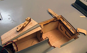

If you have been following FlyingRC.net you know that I am working with a brand new Top-Flite Giant Scale P47 Razorback that I recently maidened on a Saturday. After four flights that day I took the plane home and got up the next day to do a thorough nuts and bolts check before continuing the maiden sequence that day. That all sounds so correct and non-threatening to the plane but I was about to find out that reality can trump the best of intentions.
While building speed down the runway the first time that day a 10/32 setscrew I forgot to check for tightness showed its level of disenchantment by spitting off the right side wheel and dropping the now-bare retract into the grass. The resulting leverage applied to the retract mount ripped it from the wing. Poof! Instant How-To story!

| Top Flite wasn't messing around when they designed the retract mounts. (left) This retract did pull out but the actual damage was surprisingly small. The only part I had to make was the cover door (right) for the mechanism. I even had a piece of ply for the job! Click images to enlarge |
