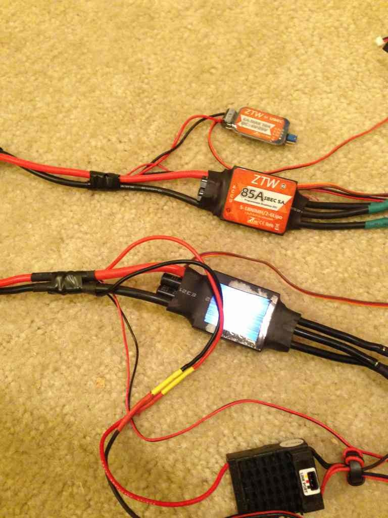

If using deans, solder the BEC power leads directly onto the connector with the ESC's leads.
If using Power Poles, crimp the BEC's leads in with the ESC's leads.
I usually add a small extension, so I always solder it in at that junction.
(The other wires you see are for my telemetry voltage monitoring)

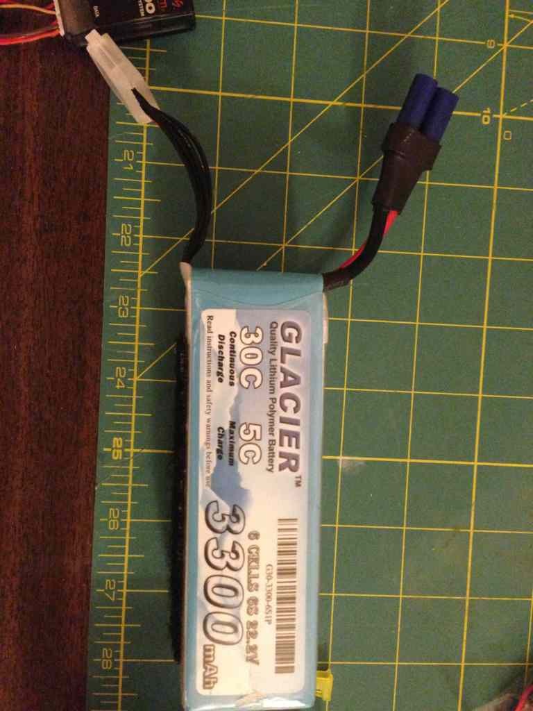

Gary looking at your picture it looks like you extended you ESC battery connection lead, how long is it? I always thought that was a bad thing to do.
The ZTW factory said that as long as the total wire from battery to ESC combined didn't exceed 12", that its ok.
My batts have short wires:
