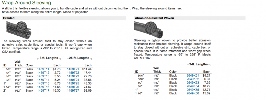

I get this stuff for my AV rigs... Can hardly cut it with a knife... protects besides just looking good:

@SleepyC , I agree with you about needing something more substantial for fuel lines or wires in an abusive environment. I would use the stuff you use in front of the firewall or on wires exposed outside the fuselage. But this will protect your wires if it holds them in place so they are not flopping around and rubbing on everything. My servo wires going to my tail servos just flop around inside the fuselage for the most part and over time I'm sure the frames could wear through them. Plus, it looks sloppy when you look back there and just see wires hanging loosely.
Ultimately, I'm more interested in the wiring being more organized and looking nice, I've never actually had a wire wear through. Just thought I would share this for anyone who just wants to clean up the interior of their plane a little bit cheaper than some of the other options that have been discussed here.
