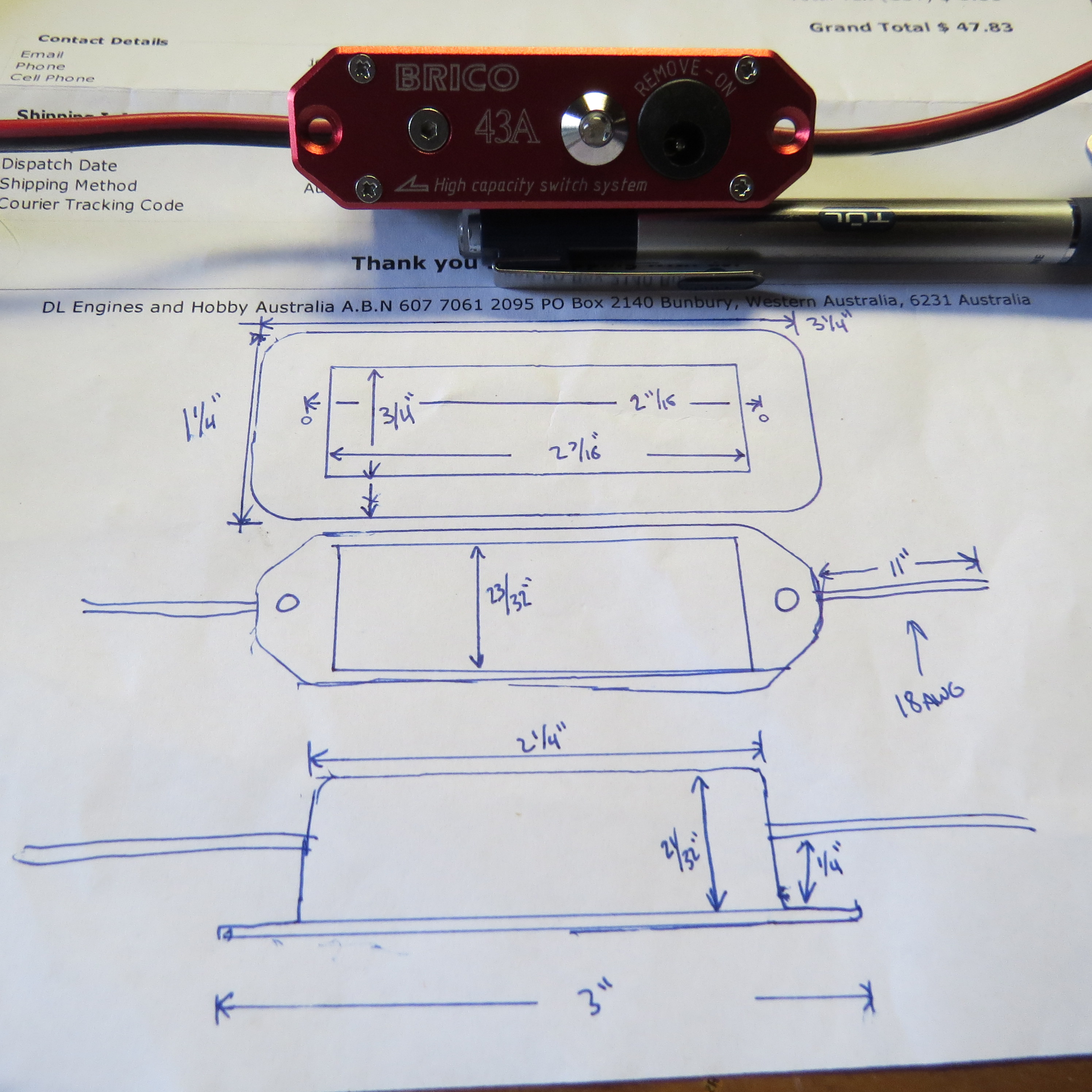

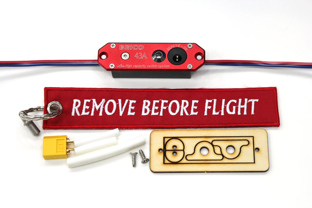

This is a Pin-Flag Switch made from a UK company called BRICO. Here is the Mfgr's Website:
http://www.brico.co.kr/item.php?it_id=14
I bought mine from DL Engines Australia for $32.73 USD with $15.10 shipping to AK. Took 12 days.
http://www.dlenginesaustralia.com/dlshop/electronics/high-current-pin-flag-switch.html

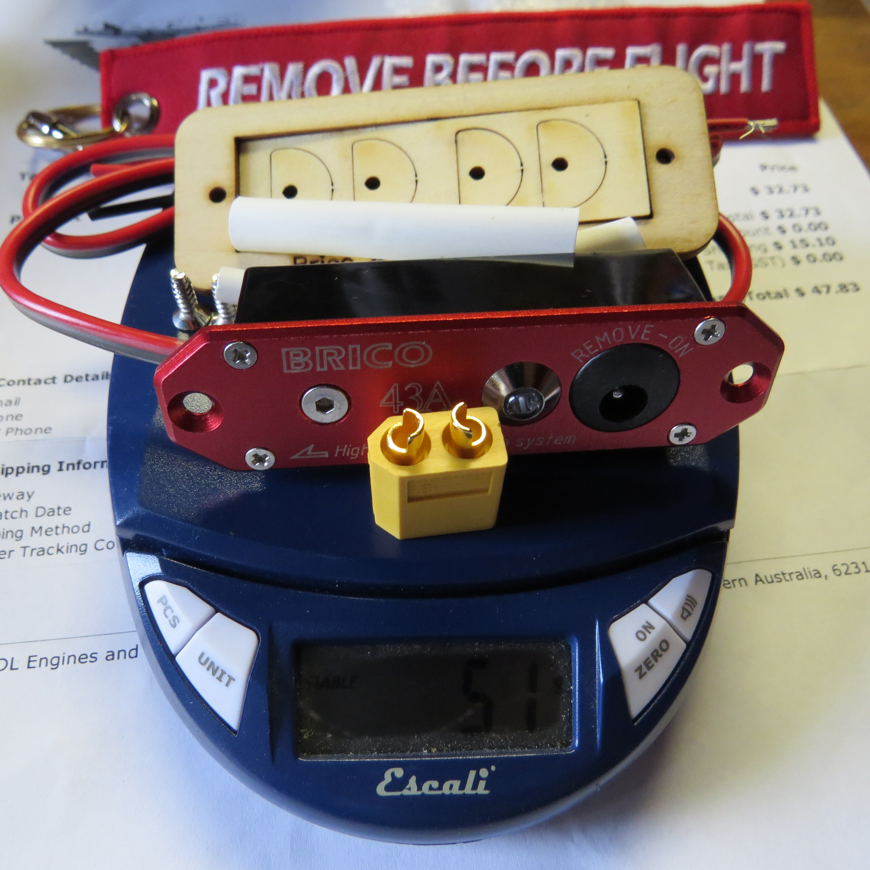

As you can tell from the pictures, I took the liberty of taking it apart and looking at the quality of the electronics, also to see if it would handle the vibration of a gasser.
AKNick

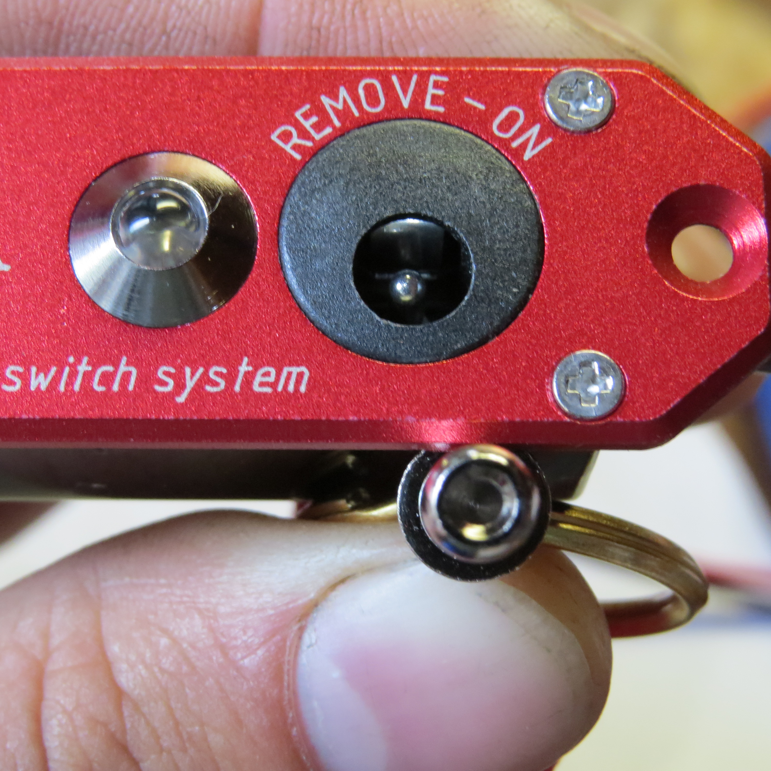

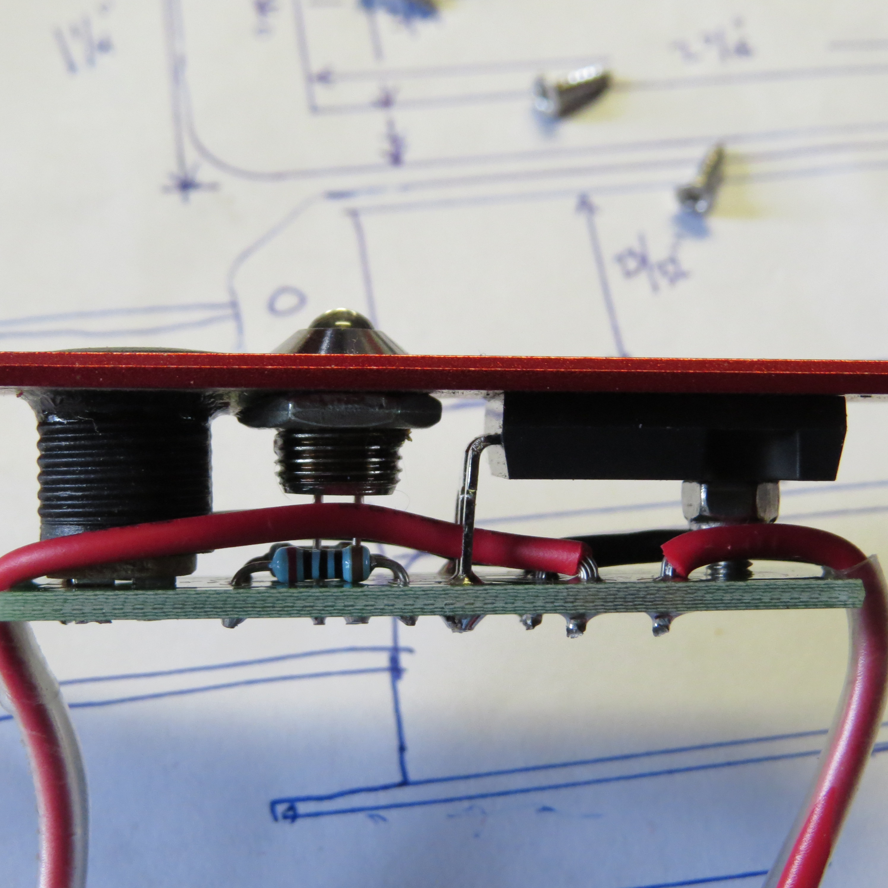

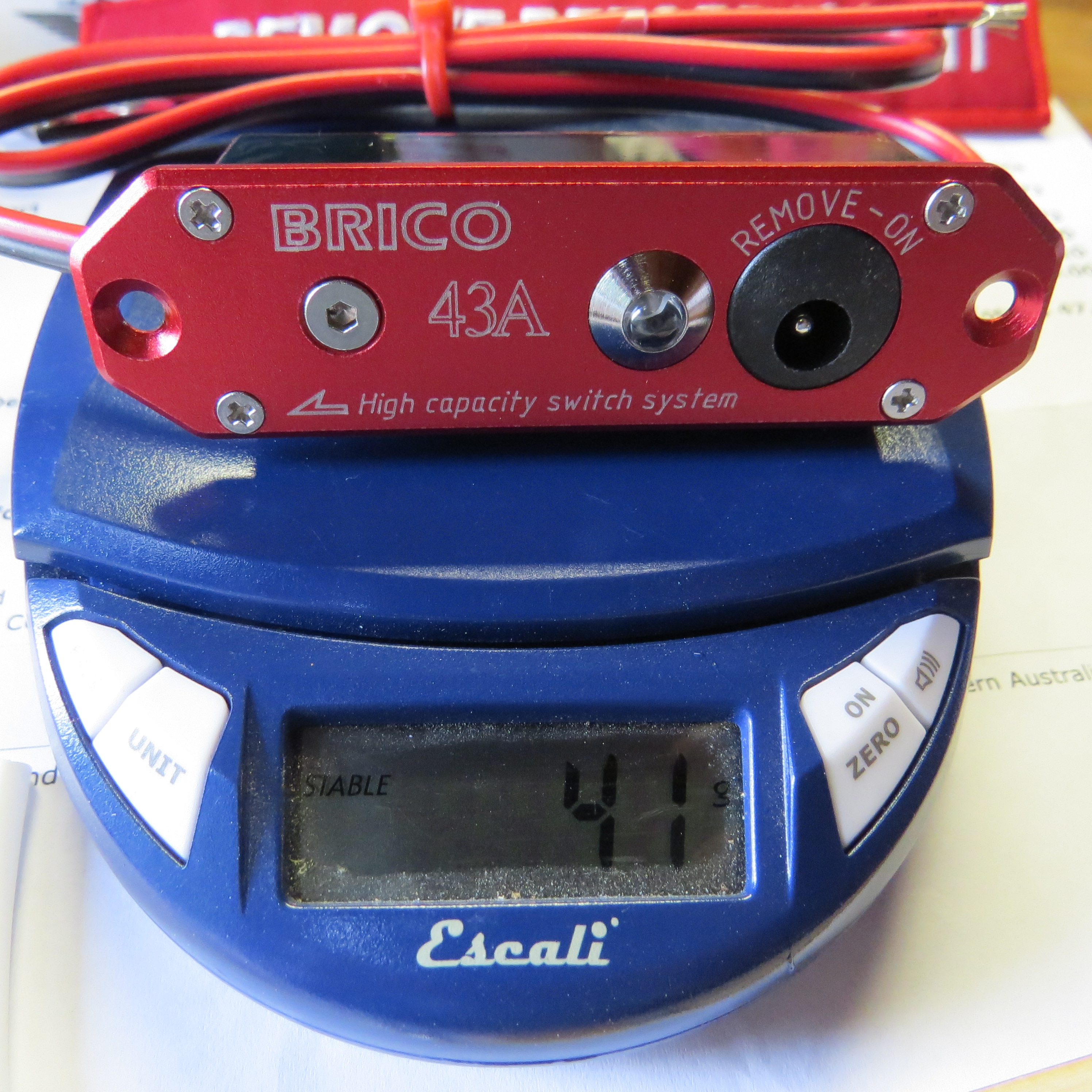

I have always wondered how these pin-flags work. Couldn't seem to find a whole lot of info, so I took this one apart - as you can see from the pictures. This one is pretty simple really.
They used a Cliff DC power plug-in FC-681473 that has a 2.1mm Pin socket. They machined a piece of stainless/plated steel to fit inside the socket that created an electrical short across the pin and tab. The actual switching is done by a N-Type Transistor IRFP150N rated at 44A. Once the pin is removed, the transistor re-directs the power. The LED is wired in parallel and the Pin Socket is eliminated from the circuit. So in flight the only thing that could go wrong is the transistor essentially (unless the pin flag socket vibrates apart and shorts).
I would have liked to see some support for the wiring & electronics. There is a small amount of adhesive on the transistor, and clear heat shrink on the 18 gauge wires. I ended up adding silicone to the vibration prone areas with regards to a gasser and heat dissipation within the unit.
