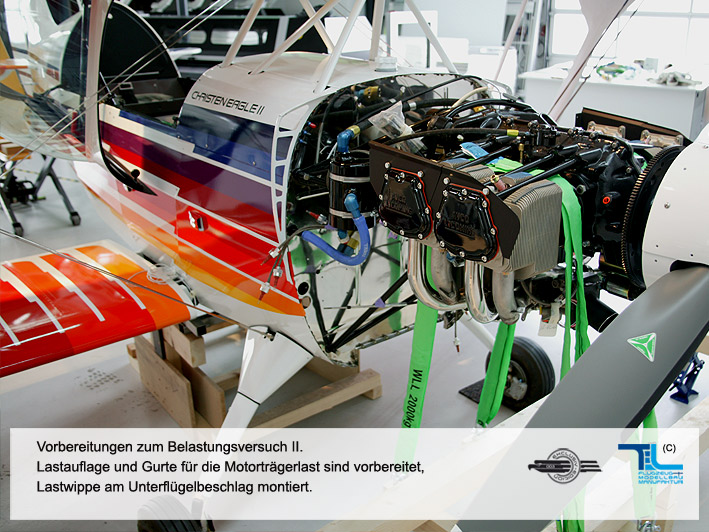

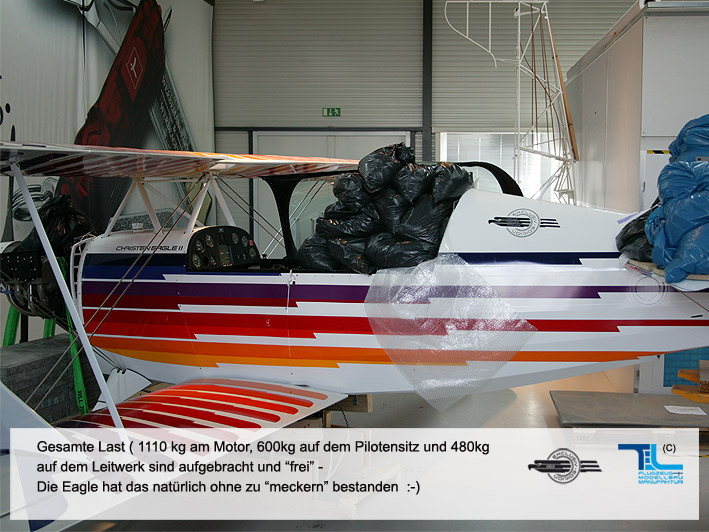

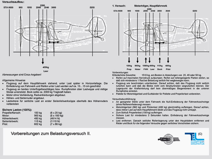

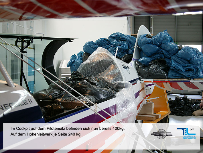

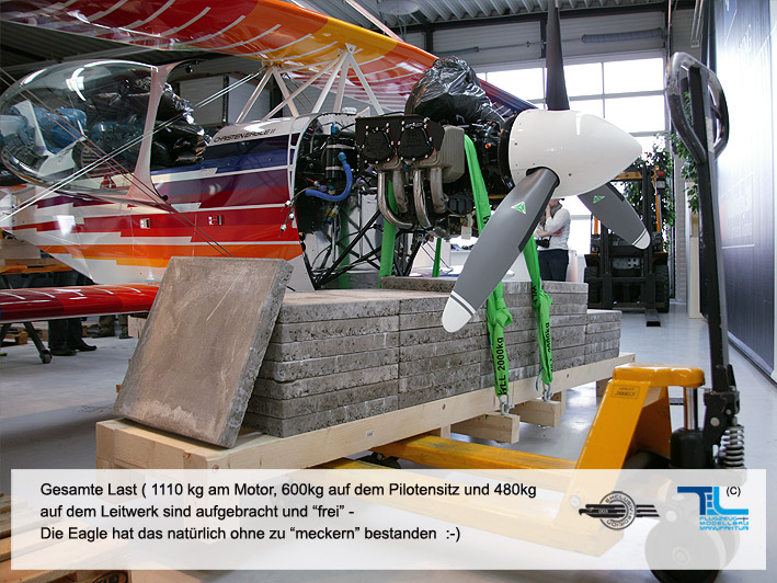

Our 100% EAGLE has passed the second and final Test on sunday, for Engine mount, fuselage and tailstructure with a simulated
force for +7g.

strap in and go test it out // your builds will not break Trust me !!! beautiful ship and shop I like the motor testing because after wringing my buddies S2.B out he call me the next day and said the motor mount was broken !!! at 1000 ft don't think we could have bailed anyway . If that was mine I would just wax on it ever day in the hanger and have a couple totties LOL! probably never fly it

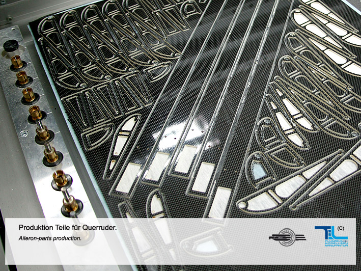

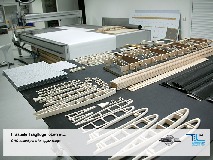

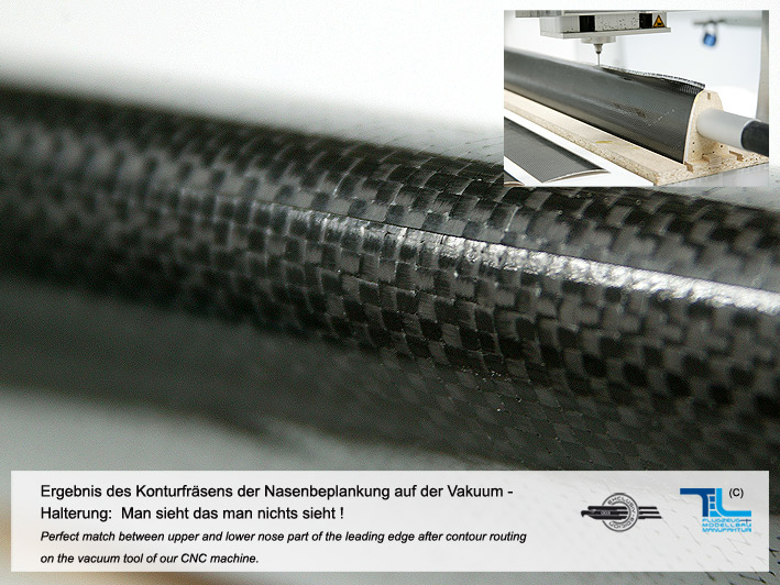

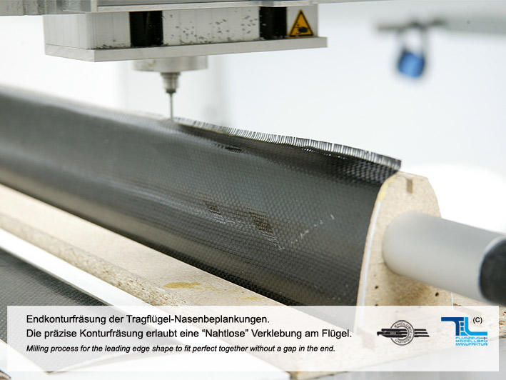

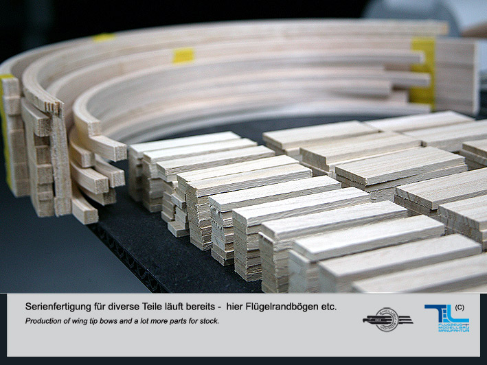

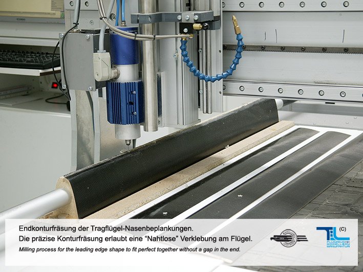

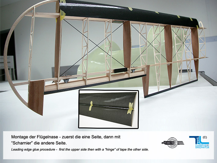

next step - constructing the jigs and helping tools for the kit parts production. To get a perfect edge for the leading edge-parts in shape and
angle we have to cut the parts with the milling mashine. There is no other way to get a part which fits together ( upper and lower part ) without a gap in the end..... Paralell we are doing the 3D scans from th3 100% EAGLE cowling, canopy and wheelpants to get perfect
scaled 3d data for the milling process of the moulds in 50%.

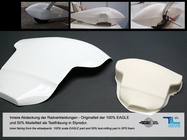

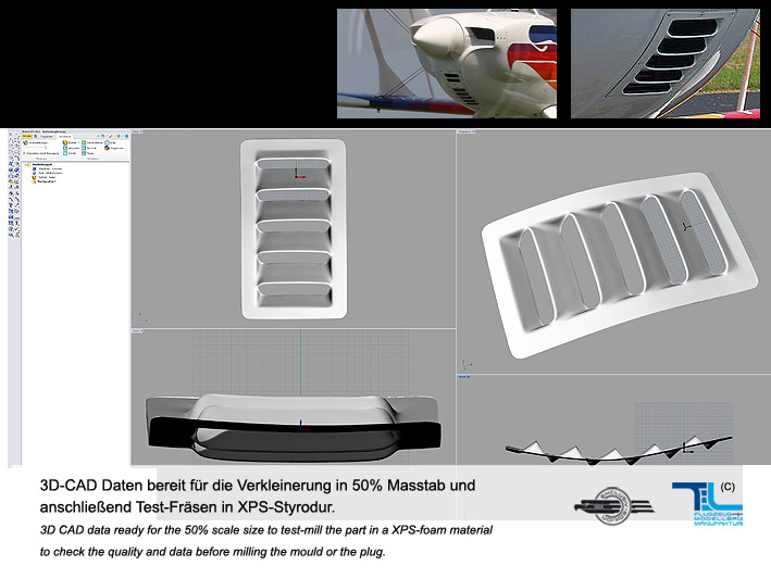

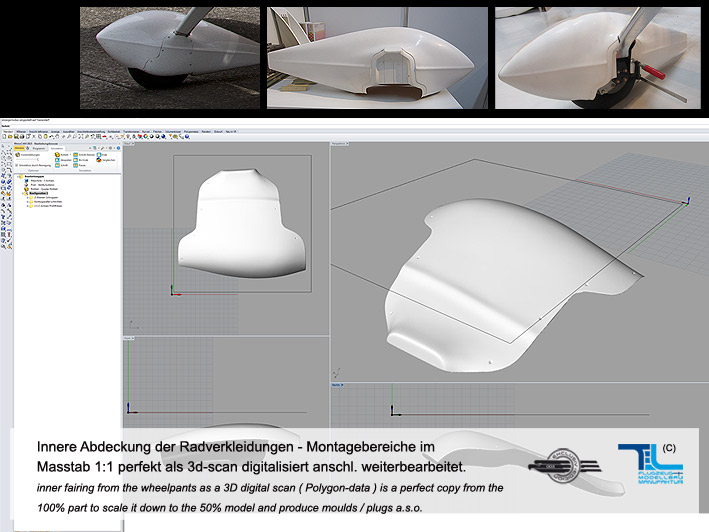

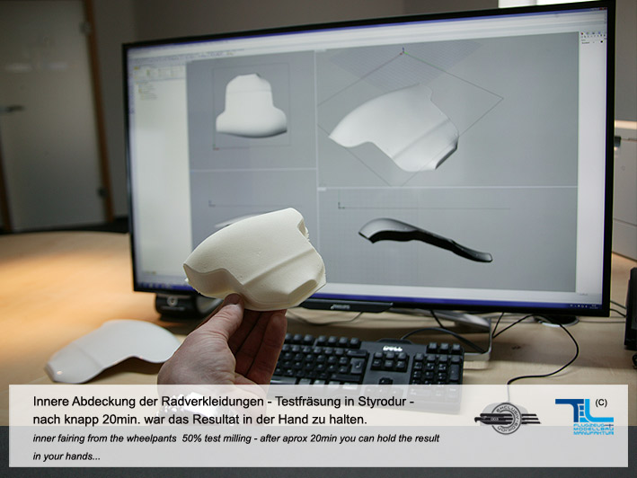

To get a perfect shape of the special and so important EAGLE design-line for the wheeplants and cowling and more
we did 3d scans to get polygone data to work with in the CAD programs.
The results for the first test milling are absolut perfekt and we can directly mill the plugs/moulds to produce
the parts from
PU or Glas or Carbonfiber.
