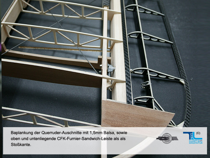

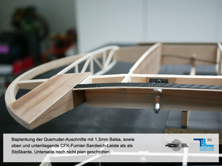

After fixing the aileron rib boards left and right, the aileron well construction is next.
TLFMM

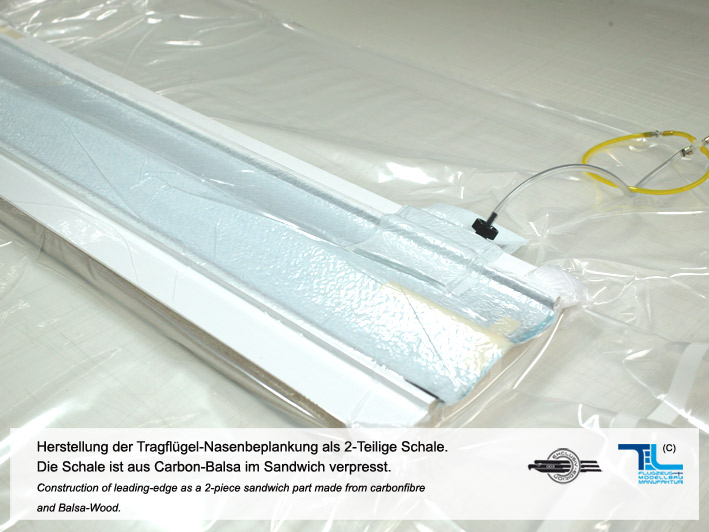

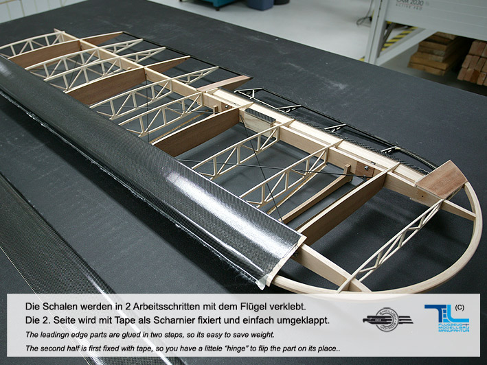

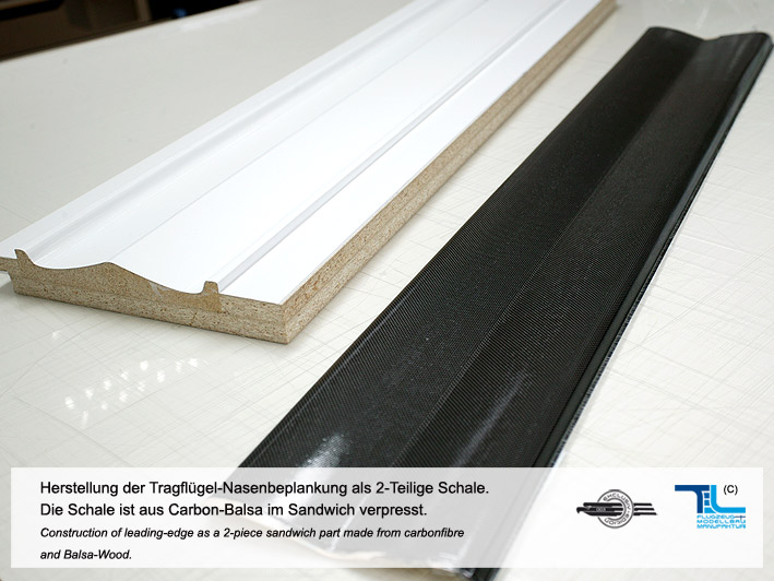

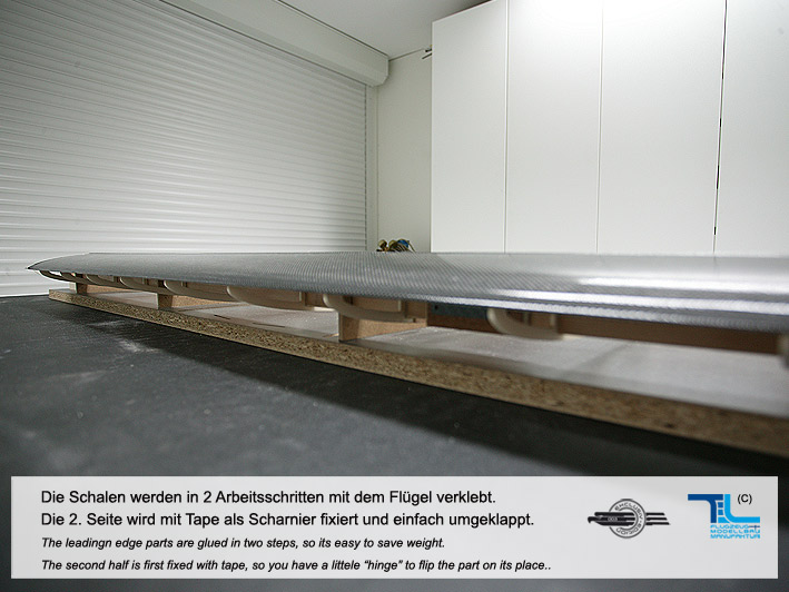

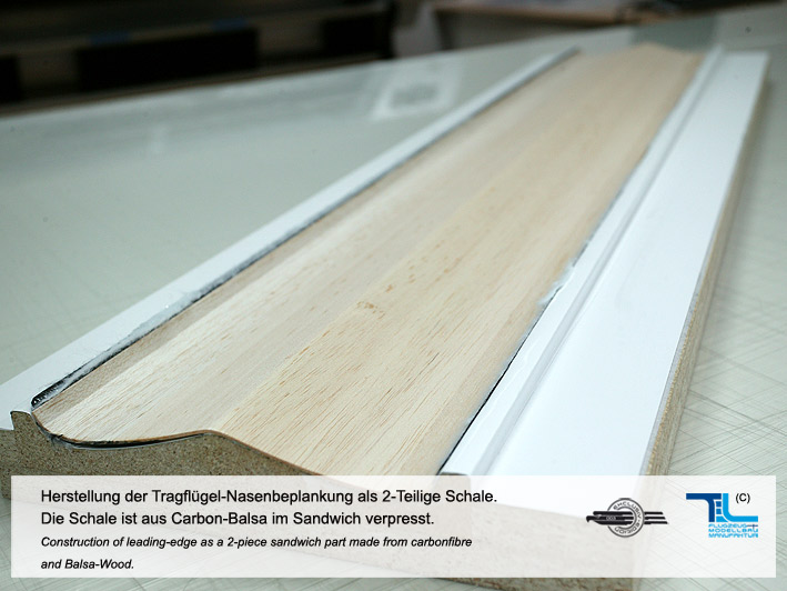

The leading edges are made as a ready to fix part, because you can save weight and
the problems with the surface while using only thin balsawood, problems with the nose
sanding and a lot more are just history ! The leading edge parts are only 70gramms and they are
very strong and no problems with the damage of surface now and later if the wings are in use.
